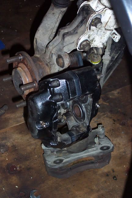

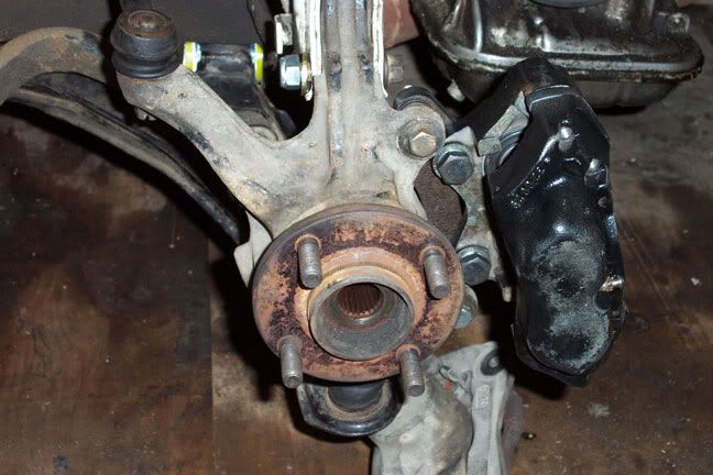

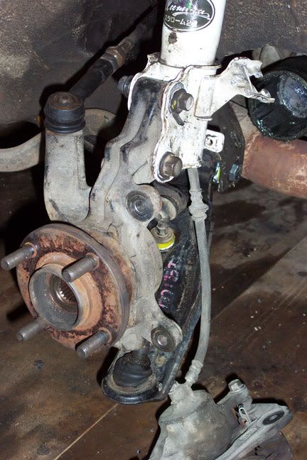

AVOGTIR
this is the volvo caliper mounted with out the rotors on the hub.
i have these brackets already made, laser cut.
the caliper is from a 260 series volvo.
then with a redrill 300zx rotor 280mm and a 8 mm spacer it should all fit under 15" wheels

nice, i wish someone would have told me that Volvo had AP 4 pots as standard and they fit the R. Could have saved myself £700!!!
So those calipers come standard on a volvo 260?
Any more info, model, year, etc?
I feel a visit to some breakers yards coming on :wink:
AVOGTIR
not sure of the year, but the caliper has to be spaced. to fit the 3000zx tt disk. as they are 30mm wide. for a kit calipers(rebuilt) and brackets, i'm looking at selling them for $500au, i know the caliper fits, but i am still unsure of the disk, as one of simular specs (r32 gtr) rubs on the lower controll arm. and currently cant afford to get one.
