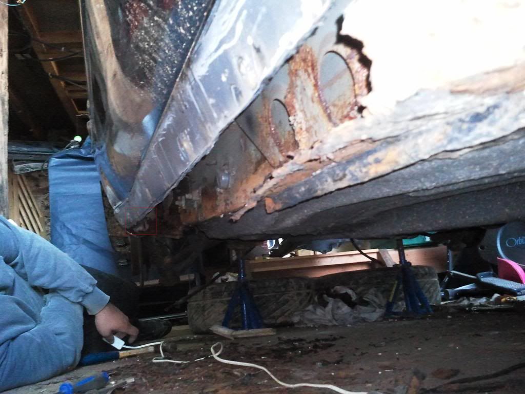

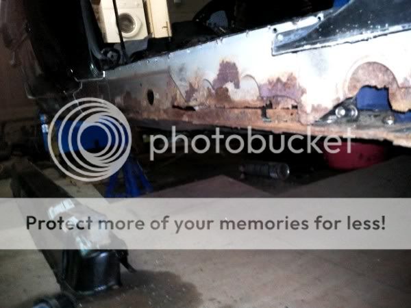

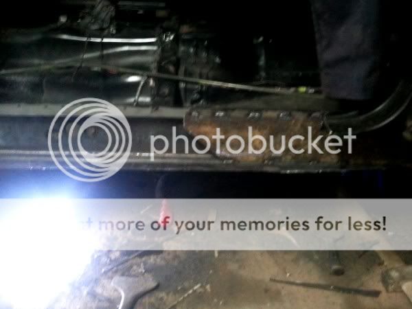

Thanks everyone for trying to help i am uploading some photos to explain a bit better.
On the 1st photo the bit in green do i need to make a new edge coming down? if so i have done what i think needs doing in pink?
question number 2 .
In this photo i have put a red square (its very light i hope you can see it) where i think should be a support of some sort as there is just a little bit of rusty metal hanging down in a square shape?? do i need to replace it ?

Just recieved the sills this morning but correct me if i am wrong i do need the pink bit that i have on the photos rebuilt so that the sill gets joined to it??
thanks
sam
SIR GTIR
yeah mate you'll need another section in there thats some pretty evil amount of Rust here buddy good luck with the repair

I'd hazard to say Mate shy of a rare member or 2 your walking unknown territory But i doubt theres anything other than the inner and outter skins the pics have disappeared i can't see them anymore but if you bring a new piece the length of whats there If you can swage the plate to bring it inline with the the remaining Inner sil thats if theres enough to put it out
But if you've attacked a Job like this i doubt your completely without knowledge
I think in this case Mate air the size of to much go heavyer gauge steel Best of luck mate be interested to see your end result
vss irvine
sam, this is how i would do it.
weld in some more steel to the inner sill, extend it down further than any other parts of the sill.
then cut and weld in your new outer sill, the inner section will still be lower.
then fold the inner back up over the outer sill, spot welding it as you go along.
this will give you some rigidity to both sections.
if you think you need to add any steel to the sills, then do it.
id wont go wrong. make sure you seam seal then underseal any bare metal or areas that have been folded.
