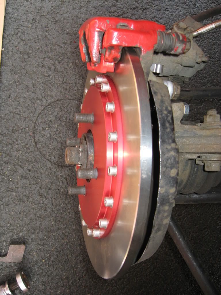

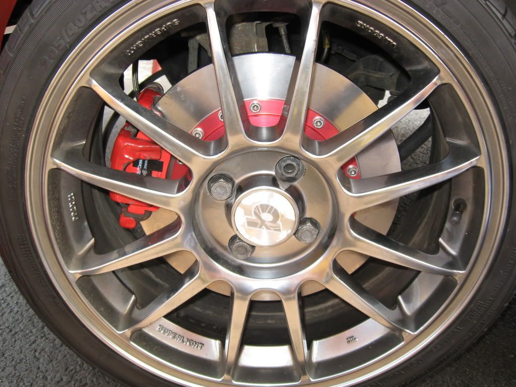

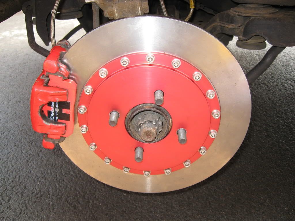

i put a thread on a couple of months ago about a rear upgrade, anyway those of you that were interested just completed the set up today using different brackets and 300mm 2 piece disc with standard caliper, looks alot better as i have 17's with the Nissan 4 pot 305mm upgrade on the front and the back looked a bit lost. I cant try them out yet as my manifold cracked and is being fabricated at the minute. Here is a couple of pics for those that are interested. :shock:
Sounds the same as the Godspeed rear kit (300mm 2 piece disc) . Although I guess yours might have a chance of fitting out of the box with no machining or extra parts (that should be supplied as standard) required.:roll:
Feck me how many bolts? Most I've seen before is 12. I think Godspeeds is 10. It looks a similar offset tho. Do you have a picture of the caliper bracket?

only a litle bit of maching to the stone gard or you can bent it back a litle with your hands. as it only just catches the back of the disc by a couple of mm.
the disc has been slighty over engineered but that is a good thing.
for strength and it shows the quality of the kit.
been tested for balance on machine and its a1.:-D
sorry no more pics yet.
