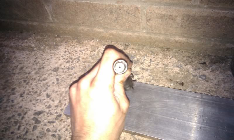

I've now got hold of the pipe that connects the standard oil separator to the rocker cover (big thanks to Stu666V :thumbsup:) i was surprised just how small the restrictor hole inside it is. I'll be refitting it to my car in the next week or so when i put my new gearbox on so will update this in the next few weeks as i've got a few sprints and hillclimbs coming up to test it out ;-)
The pipe in question:
Restrictor inside:

Cars I have in also suffer from spitting out oil if the stock separator and pipework is removed. The purpose of the black box is to allow crank case gasses OUT but not allow oil out. So when you remove this AND the restrictor pipe and go giving it big balls on a track your going to be in trouble...
Its quite interesting as Nissan wouldn't have put it there if they didn't need to ;)
