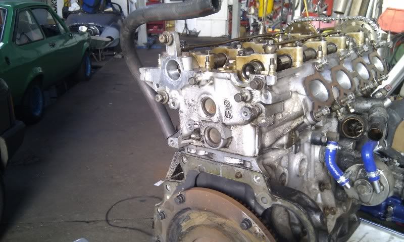

I stripped my engine today and I think the best location for a fitting would be to knock the upper core plug out the side of the head and machine up something to go in the hole. Will wait and see where all the oil collects first though.
My engine refresh has turned into more work than I originally thought now after finding this earlier :lol:
give in
I think the biggest problem would be making something in that location and having to avoid all the coolant pipe assembly.
I'm interested to see what you come up with.

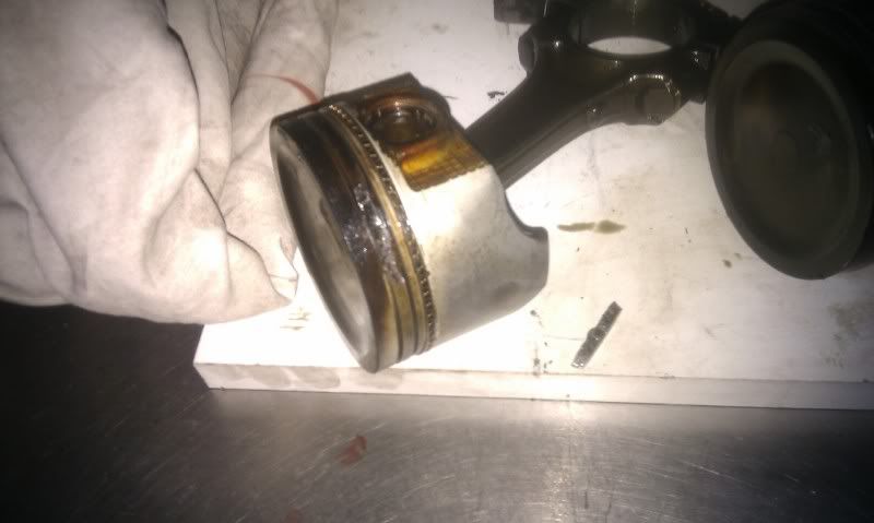

Due to being pushed for time and only finishing building my engine a few days before castle combe sprint back in march i didn't have time to try any additional oil returns so ended up just overfilling the engine by around half a litre. This did the job but the original problem is still there as i probably had over half a litre of oil in my catch can after the 2 3/4 lap practice session.
Has anybody ever pulled all the internal baffling out of a rocker cover? If not this one is getting butchered :lol: Just interested to see how far along it the oilway to the tee on the end starts, as looking at it i reckon you'd need a hell of a lot of oil in the head for it to actually run out that side of the rocker cover under cornering which is what i thought was happening :?
Another thought i had was due to my exhaust manifold shape i've replaced the standard oil separator with a piece of rubber hose, could it be that the oil is actually coming up through that from the sump at high revs and due to all the oil being over that side of the engine?
