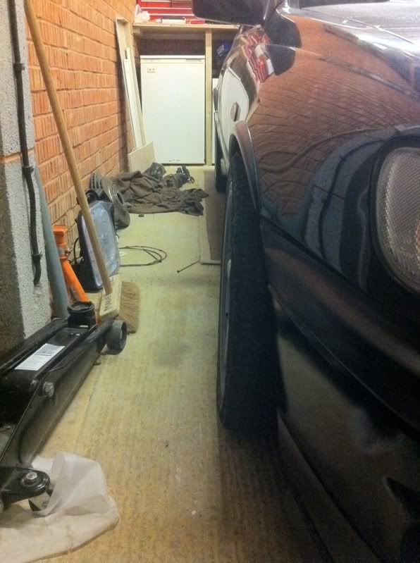

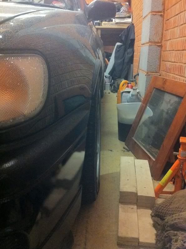

right guys need some advice now since rebuilding my front driver side corner after having a caliper seize up and lock my front wheel at 70 odd mph now it got a complete new set of coil overs hi spec big brakes new alloys and now it just needs the alignment doing but my problem is why is the drivers side wheel stick out out about half an inch further than the left hand side i'll add some photos in a sec

havnet changed the lower wisebone didnt think id be able to bend that and yeah the offset is the same
the wishbone is design to fail before the chassis, compare it with the other side (off the car) and if in doubt change it and the hub carrier, i bent both hitting a kerb before

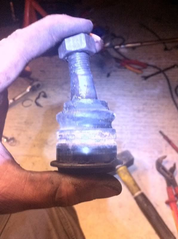

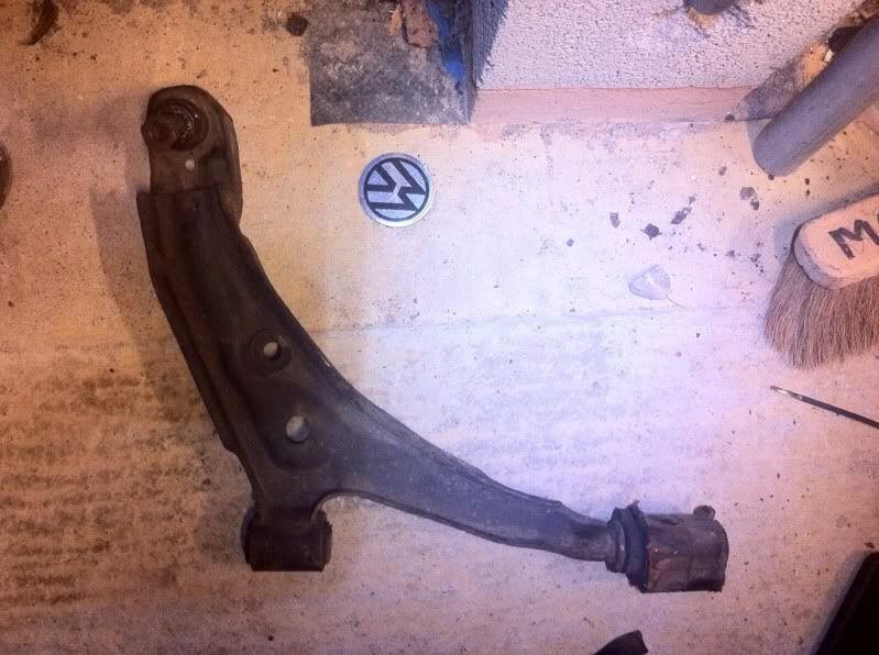

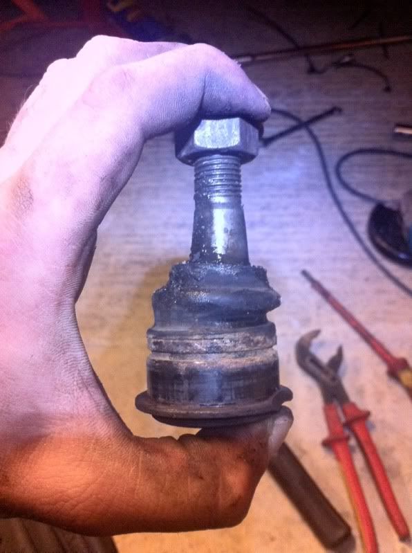

I've got my wish bone off andnit doesn't look bent not to say that it isn't but we will soon see when the the new comes but here it is anyway
When the new one comes, put them side-by-side. It doesn't have to be very far out to make a big difference to the front-end alignment.
nope it should be straight! that has had a shit load of force to bend that and your wishbone is bent as well looking at the photo there is a large dent in the front of it.
