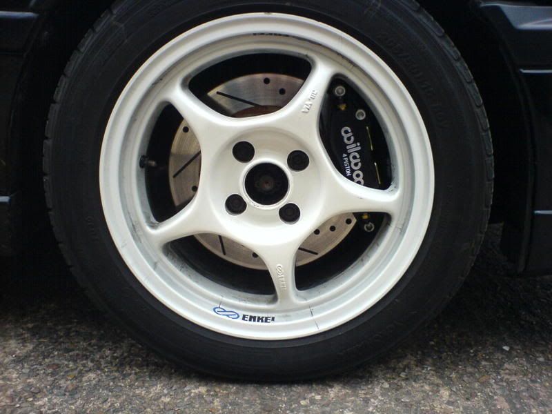

I'v got the 285 willwood brake kit with the rota slipstreams. The offset wha 28 I think (I'd have to check) and it clears the spokes with loads of room to spare. I can also get me enkei's on but need 3mm spacers so the valve cap doesn't hit the calliper. Pics below:
If you need any info or extra pics I can take so for you?

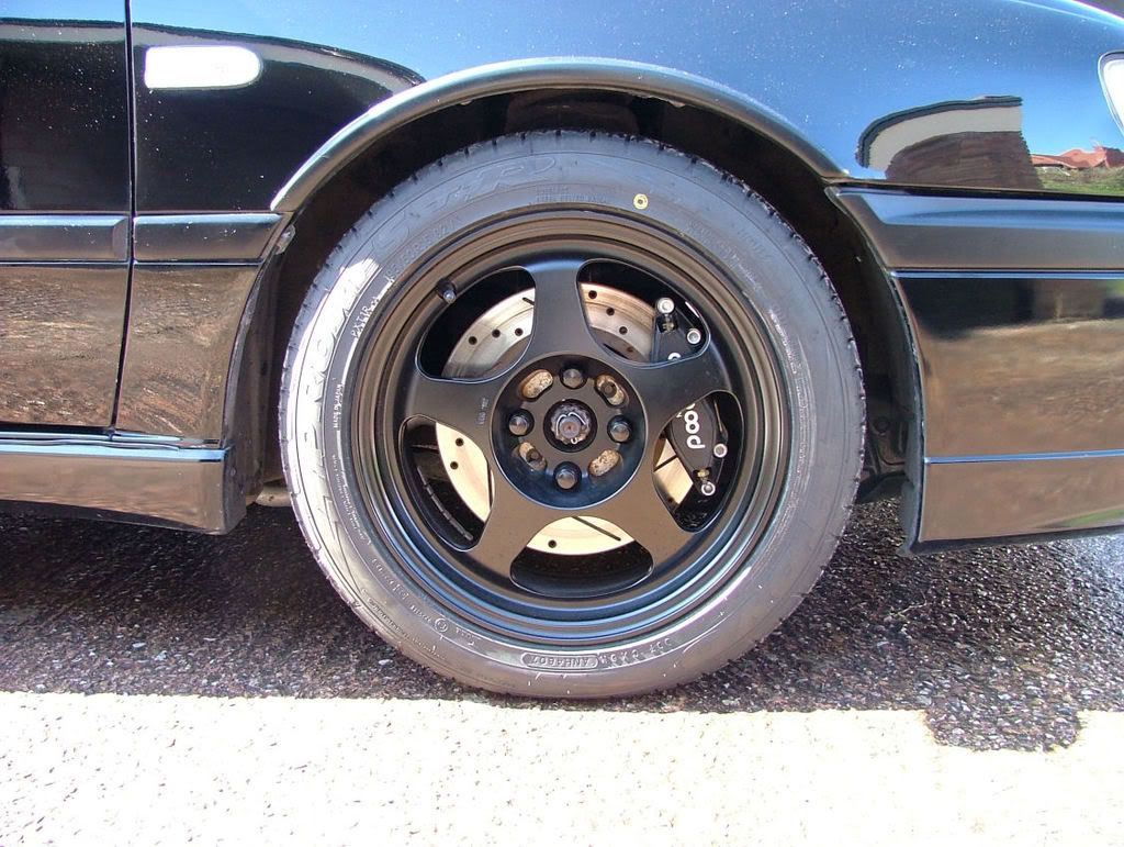

I have today pick up and fitted a Rota Slipstream wheel.
15x7x28ET. This was onto a Willwood 310 brake kit. I was supprised by the clearance without spacers. On the inside of spokes there was about 8-10 mm and clearance inside of wheel was about 5mm.repeat this was without spacers, whereas with my 15x6.5x40ET I have to use a5mm spacer. I agree with what has been said before, not all 15" wheels are the same.
