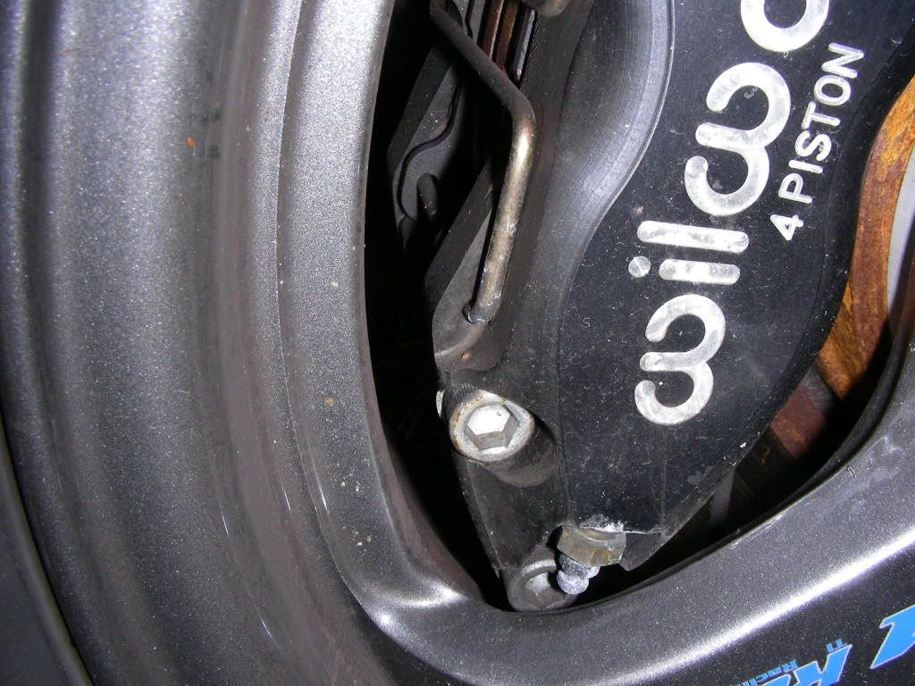

I have wilwood 285mm midlight brake kit on the front and run 15" rims.
As you can see from the pic, I have just under 15mm clearance to the rim and about 4 mm to the spokes.
Wheel is Team Dynamics with et37.
This kit did not fit under my Buddy Club 15" rims with et42 as the caliper fouled on the spokes so I run them with 10mm spacers. Have about the same 15mm clearance to the rim.
You will be hard pushed to fit a 310mm kit under 15".
The wilwood 285mm kit is ok.... I would like a bit more braking but really want to keep running with 15" rims.

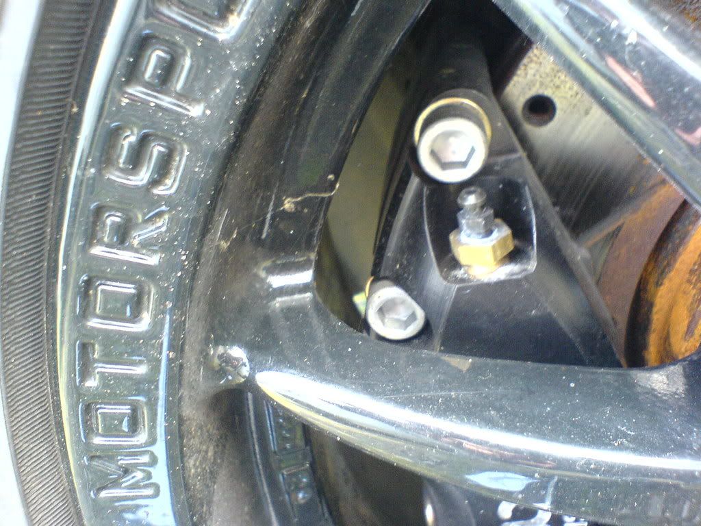

Here's another couple of pics of the wilwood 285mm kit under 15" rims.
Buddy Club P1's with 10mm spacers fitted to clear spokes.

iirc Buddyclub 15" are only available in 15 x 6.5, that's why they do no fit aftermarket brakes without spacers.

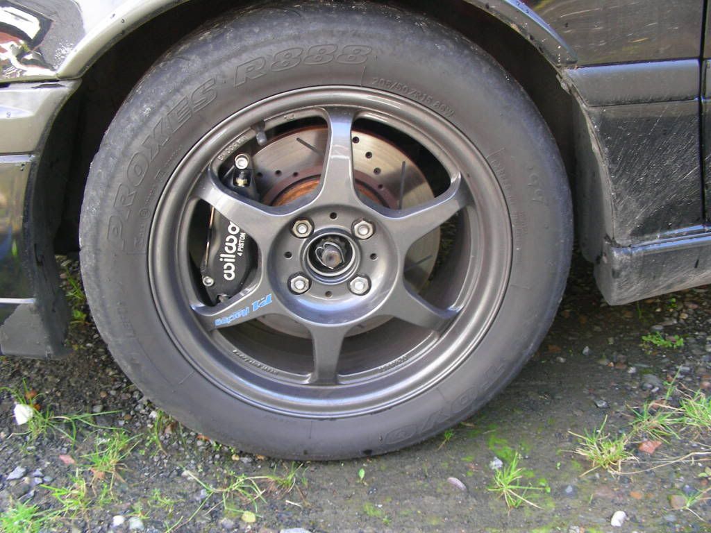

I run with 310 Willwoods under 15" Rota Slipstream shod with Toyo 888 soft compound tyres using a 5mm spacer.
:thumbsup: Would you mind sharing some pics and the width and offset of the 15" rota slipstream please.
dencon
310 brakes
I have about 3mm clearance on the rota wheels, you have to put any balancing weights well to the inside of wheel.I am not sure what the ET is but I will check tomorrow and get back. I think they are 40, you can get slipstreams with ET 28.This should give a little more clearance.
