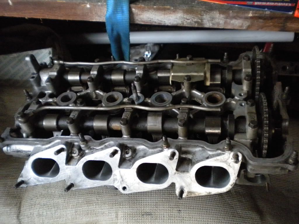

Ok, so I've removed the head cover today, and measured clearances. I don't know if this is considered a hot or cold motor; I got to work on it as soon as it had been parked, and ambient temperatures were around 7c I guess. The head was radiating heat while I was working.
The clearances were as follows. I measured at each end of the cam lobe, so each cam lobe/rocker arm has two columns. The measurements are of the biggest feeler gauges I could fit (in 0.05mm increments), and the ones that were real easy to get the feelers into are marked "easy fit", so they're not immensely far off eachother.
What I'm wondering is - is this ok?

You would hear it at idle mate, your head sounds nice and quiet really - from watching that video at least.
You did a good job of building it in the first place!

those shim clearances are fine trond (especially as the engine was not completely cold)
the noise you can hear is exhaust blowing slightly....which will obviously get worse under load!
we aim to set them now at 0.10mm cold which is 0.05mm under manufacturers setting.
ive figured out that from cold that any clearance is ok as they get bigger when hotter so providing you have some clearance youll be fine.

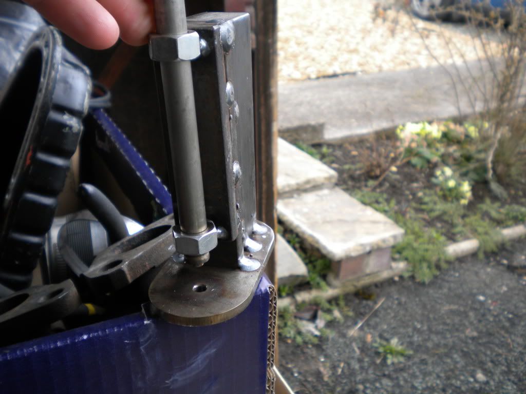

Sorry for being a complete idiot, but where and how does that attach to allow valve clearances to be measured? :/
Ta,
Dave
watoga
LOL! I'll take your word for it! ;)
Seriously though, I get what you mean :) Can't have enough information though before I try and attempt this myself........................
