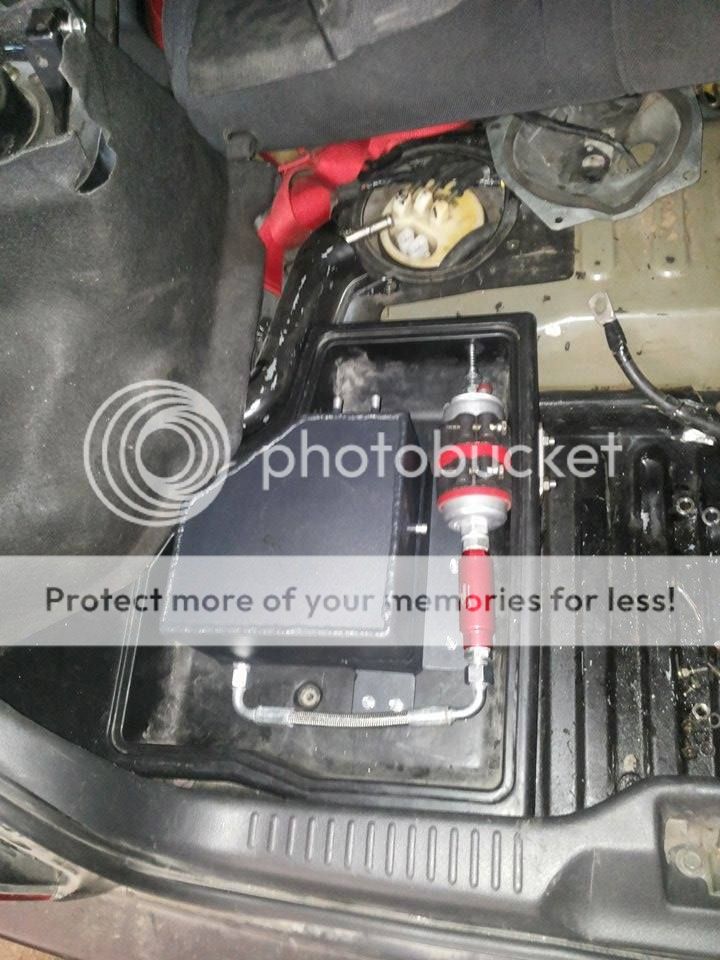

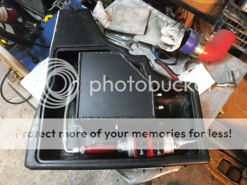

I'm suffering from surge because the sock on the end of my 044 is not low enough I assume, its not a standard style sock.
I am considering getting a barbed end for the pump and a length of hose and putting a standard pickup on the end of it to get it a low in the tank as possible, my only concern is that the sock will be "loose" inside the tank.
