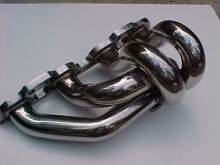

Ive managed to locate a tubular manifold for the R, but the owner says that its for the HKS 3037S turbo which is far too big for my current needs.
What other turbos have similar fixings to this turbo, as im looking for quiet a high spec while keeping standard internals (well until they decide to break :roll: )

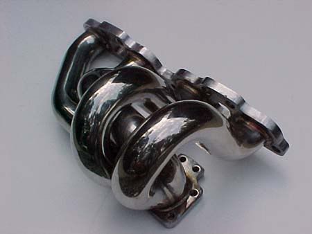

ive put a couple of pics below for you of the manifold

jiw said:
thats a t25 exhaust inlet flange, mani looks a bit ss autochrome :cry:
Yep they have confirmed its a T25 flange, made out of 321 stainless which ive been told is good stuff, and the pipes are 41mm so it doesnt sound like a ss autochrome special, and if it is then il get one made up using this one as a guide :!:
