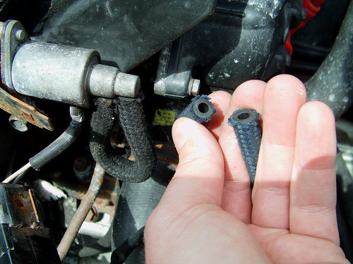

								By-passing the solanoid should give you only 0.5bar, as this is the standard spring rate on wastegate. The boost solanoid bleeds off 0.2bar and thats how you get the standard 0.7bar. Not sure why yours is boosting at 1bar tho :sMikey_pulsar said:I've just done this....we drilled a hole of 1.5mm and it boost to 0.8 bar,
So we completely by-passed the solenoid to see what happened and it sat dead on 1bar boost....is there any reasons why i couldn't keep it by-passed? do you think it would be alright?

Are you reading these figures from the standard boost gauge, or you have an aftermarket one ?i joined the intake and actuator pipes together and took the car a run would only boost to 8 psi then joined he 2 solenoid ports together took it another run and only got 10 psi in 2nd gear at 4500rpm. should the car be at 14.7psi (1 bar) by then or do i have another issue? car is running standard turbo, blitz filter, forge dump valve, fmic, iridium plugs, magnecor 8.5 ht leads, 5zigen, decat, etc.
