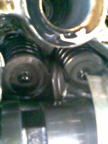

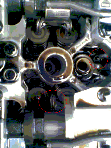

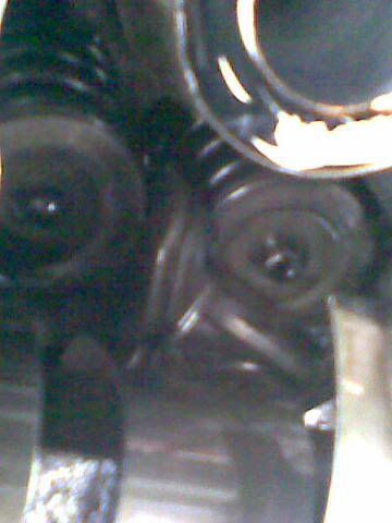

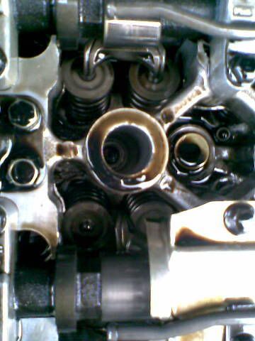

Done this and the pics show the results.
Rocker had moved to side slightly and knocked off the shims.
One of the shims can actually be seen in the right hand side by inlet cam.
Rocker sits on shims which sit on valve springs.
a relatively easy fix by removing the cam and replalcing shims if needed and re-fitting Rocker.

Rocker slipped off shims/vavle springs
More general view:
Rocker and shim circled, relief!!
More general view:
