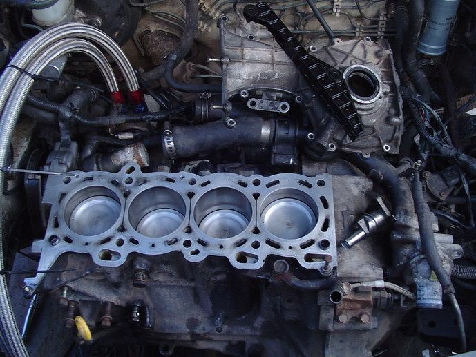

Can anyone tell me if this head gasket is the right one for the GTi-R or not? Doesnt look right to me as nearly all the holes for the water jackets are blocked off. Unless its a new design or something?
Looks to me like most of the water jacket holes havent been punched out properly when the gasket was made ;-) I take it its been fitted at some point looking at the state of it, what happened when it was run?You can see from this pic of my engine that its the right one, just with a few less holes than its meant to have :lol:

they're not meant to be.
my hks is the same, although you seem to have one extra hole :lol:

Yeh the gasket was fitted but the engine was never ran. Nearly all the bolt holes stripped their threads when the head bolts were being torqued down.

I had questions when my Cometic turned up (and it looks just like your one). The original Nissan gasket had most of the water holes around cyls. 1,2 & 3 blocked off, but the Cometic had small holes punched in these blocked off areas. Supplier checked for me, and that's the one Cometic recommended and they have used on several builds.

Thats good news :thumbsup: one less problem I have to worry about. Just need to sort out these stripped threads now.
