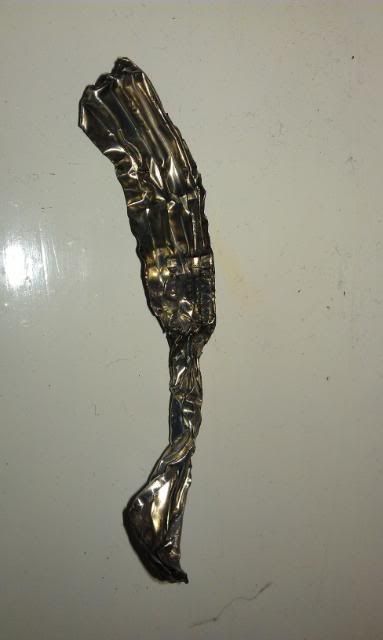

engine revving on its own
looks clear plastic to me, poss an old pipe?
It looks a bit like the shrink wrap you might get on the top of something... or like a plastic bag used to block the pipework when the turbo/exhaust manifold was off.
going by the burnt colour i would say its a bit of foil heatwrap, cellotape or something.
youll probably find it dropped down turbo outlet pipe or maybe even off pipe going to plenum if you lagged it, so it wouldnt have gone through turbo hopefully.

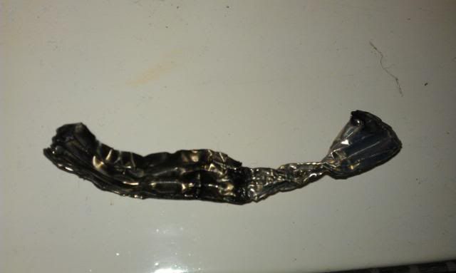

right pulled the object out of the throttle tonight and it appears to be some form of foil, now although i'm not certain, i've never seen anything like this on the car or with any packaging from the parts i have installed/replaced. My engine is completely standard apart from a pace front mount. Could it be some of the internals of the intercooler?? the ends appear smooth/straight so fairly confident no other bits have ripped off and are still circulating around the inlet/head/engine.
Its about 3" long, has a corregated appearance and is a ragid foil material (so would have done some serious damage)
Got all the car back together and it didnt sound good when first started, unplgged the battery for 10 minutes and tried again. Left running for 5 minutes and then went for a drive as the idle was hunting around a bit. long story short after 15-20 minutes the car began to idle as before with the turbo hitting near 7mmgh on the standard boost gauge and the brakes are fine.
So hopefully i've been a very, very lucky boy, although i've not idea what this object it or how its got there. One thing i do know is that i'm double checking all pipes if i work on the car again

Looks like Speed tape to me. Is it sticky as hell on one side (maybe not anymore). Used on aircraft to temp repair aerodynamic surfaces or to stop water ingress. I would describe it a (normally) 1" wide very thick tinfoil that's really sticky one side and very smooth the other and quite sharp to handle.
My car is virtualy held together by the stuff.
You can get it much wider than that as it can be a temp repair for small holes.
No nothing has been powder coated on the car.
With regards to the foil, both sides appear identical so don't believe it to be a tape of any form and can't feel any sticky substance on there any more.
Brakes and idle are now fine, so will be doing a compression test over the weekend for peace of mind.
Anyone know where I can get the intercooler pressure test to make sure, firstly there are no obstructions and secondly it isn't leaking?
