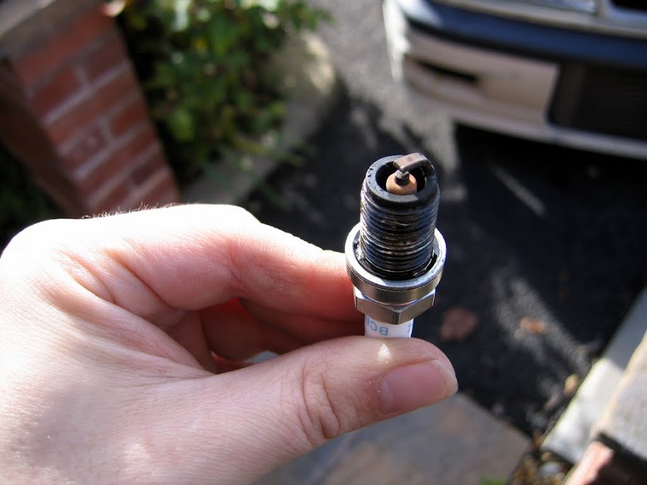

How are your plugs? I think mine look ok - a little dirty on the thread, but the tip looks good and that orangey colour is indicative that it's pretty stiochiometric.

My plugs look similar to yours - perhaps a little whiter...
