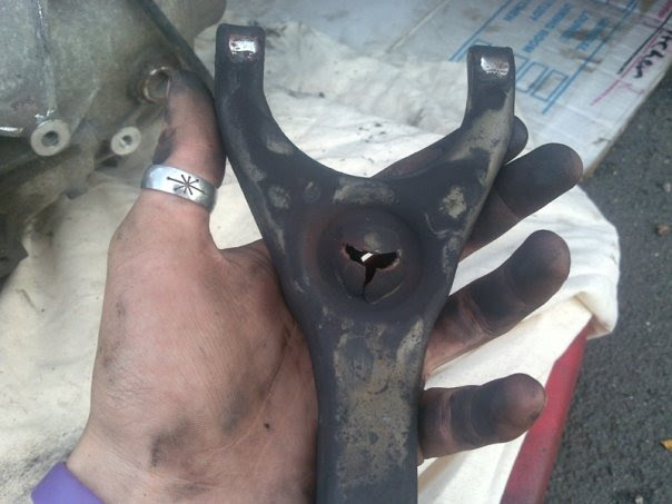

As you said, could be the fork itself - this happened to my previous Pulsar;
It's a bastard but there are options out there to make sure it never happens again.

Removed the boot over the slave cylinder this morning. Checked out the clutch fork with a borescope
A semi confusing photo, top left is the silverish pressure plate and you can see the throw out bearing mated to it. Bottom right is the clutch fork. As you can probably tell the clutch fork has infact split right on the ball pivot. This is causing the pedal to feel light or loose as it hasn't broken off completely yet. Just enough to not allow gear changes.
I'm glad I went ahead and ordered parks. The clutch fork I already have but the mt90 and throw out bearing are already here. Waiting on a new retaining spring
