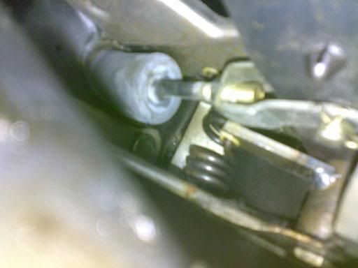

whats a support bracket? am interested my clutch is hard
It looks like this:
I think the one Steve makes is pretty similar. - It won't help with how hard your clutch is, but it should minimise the lateral movement of the pedal which tends to be what causes the box to snap off the firewall... someone correct me if I've misunderstood that.
stumo
It looks like this:
Yeah, it helps to stops the bracket twisting.
warringtonjack
If it just needs adjusting the bite point, this is what you need to be looking at. I'd try this as a first port of call, but you may as well add a support bracket as well anyway, as it is a cheap mod and gives better peace of mind.
