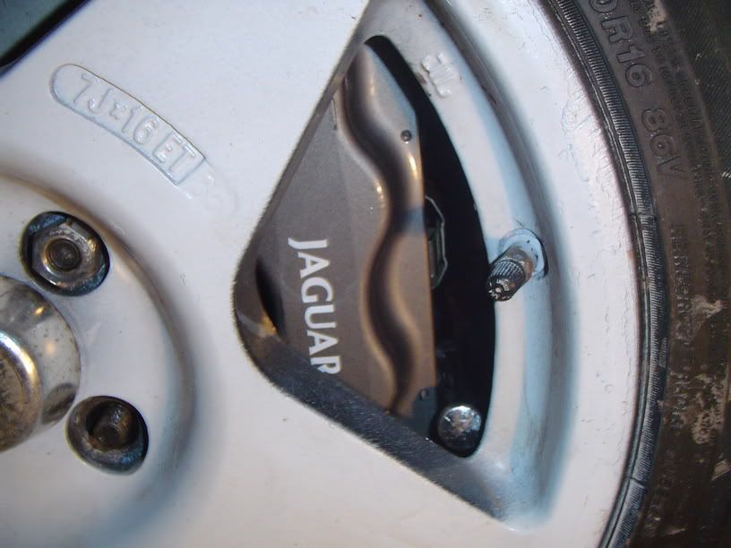

I've just finished measuring up and trying the calipers i've got under my wheels and i reckon i might just be able to get away with 320 mm discs 8)
The calipers are bigger than AP 4 pots and they are nearly touching the wheels :lol:

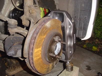

Just need bigger discs now :lol: This is the same caliper thats used on an Aston Martin Vanquish 8) This is the Jaguar version though which uses lug mountings instead of being radially mounted.
Hopefully what it should look like when its done, but without the cardboard disc :lol:
