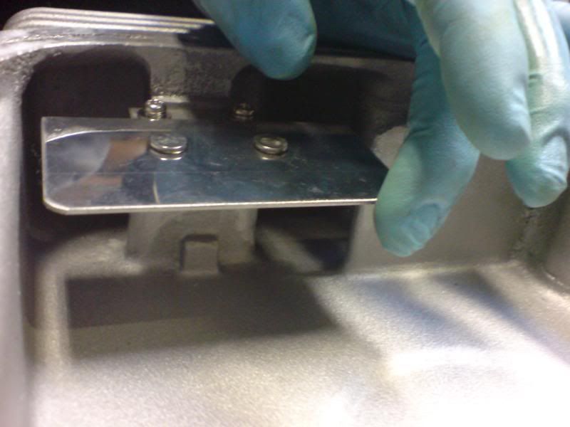

Something like this can be done ....in my own opinion is the cheapest and best way.
....the aluminium part should be made bigger with some side extensions
And on the oil pickup tube should me made like this
Gates and baffled sumps only work in one plane, as my mate just found out at rockingham witch is a anticlockwise circuit. Besides if you are going to that much trouble it's just as much aggro to make a dry sump setup using the standard pan and oil pump with pick up, just a matter of fitting a differant oil filter replacement housing on the back of the engine and a new pressure pump and drive on the front with the associated lines for it all and a resovoir and cooler.
other problem with fitting big wing and baffled sumps on the gtir is Clearence with the ground.....even standard sumps get bent regularly remember.
