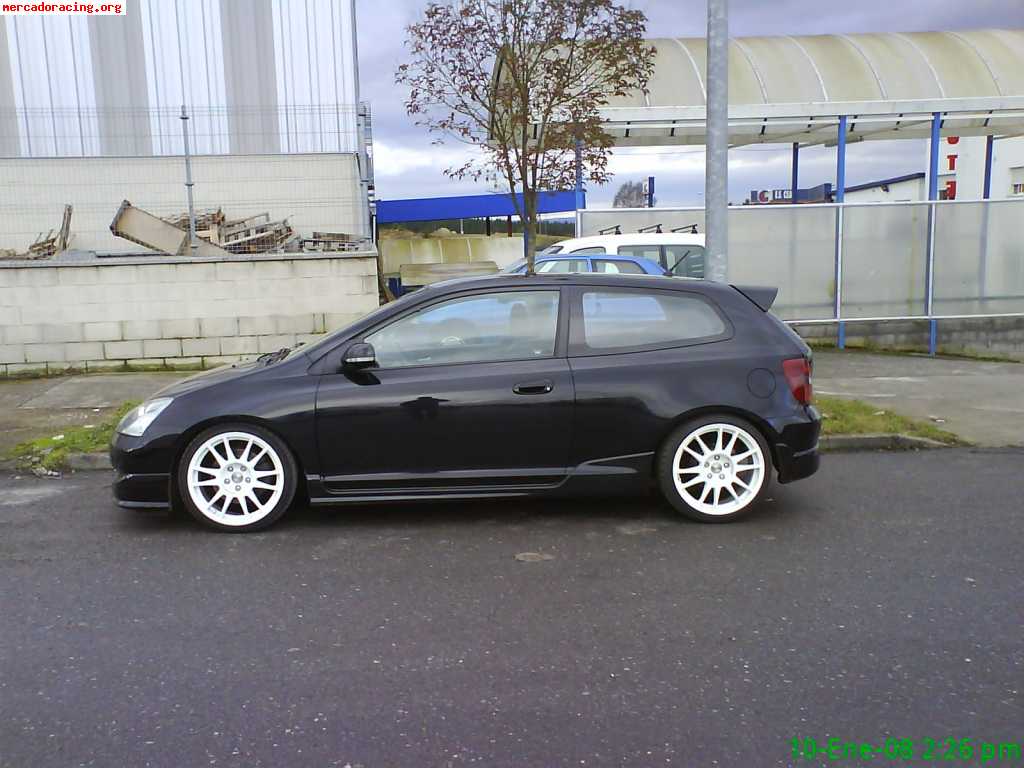

hi guys..
anyone have fitted the 8x17 on his R?
what do you think about the tyre on the R?
I want do 450 bhp from my R..205/40/17 on 7x17 or 215/40/17 on 8x17?
thanks
bye
ps. if possible post pics about 8x17 on the R..
I have found 8x17 et 31..and I have this question before buy it
Andrea
I think stay very well
rims meausure:
external meausure(exit out of car):
7x17 et 20(my)=67,5mm
7x17 et 35= 52,5mm(stay good with d2 coilover)
8x17 et 31= 69mm
8x17 only 1,5mm out from my 7x17 et20
internal meausure(to the coilover)
7x17 et 20=87,5mm
7x17 et 35=122,5mm
8x17 et 31=100mm
d2 fit well under 7x17 et 35..my 8x17 are et 31
122,5 - 100=22,5mm of clereance :D
I think fit as well on my R this 8x17 :)
any one has got pics about 8x17 on his R?
now I have 7x17 et 45 with 25mm spacers..and look very very good..
I want remove the spacers and have the same effect..
but there aren't 7x17 et20 or similar..
with 8x17 et 31 are similer to 7x17 et20..and in the future I can install 215/40 or 225/35/17
