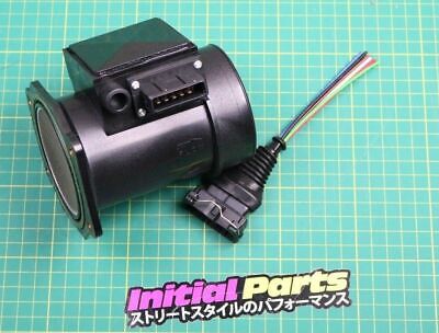

No.1: is this ok to buy or do i really want to get an original Nissan part?

By the looks of it that's ok to buy, someone will correct me if i'm wrong, have on experience with them i'm running map

I remember looking at the price off a new z32 some years ago it was around £300 this is brand new ! and not a Nissan original . Possibly a Chinese copy if no one on here pops up to say yes I've bought one and its fine i think its a case of buyer beware .

Just had quick look on e-bay you can buy the same one in another advert for £26. 98!! yet second had Nissan one are going for upwards of £120 or more .

I've compared both the internals of a genuine Nissan Z32 and the Chinese knock off and I'd NEVER run a knock off again!
The parts inside the cheap one was laughable and highly suspect on its quality, durability and also accuracy...
I'd buy direct from Nissan to ensure I bough the a quality item, rather than having something shipped from "CHIYNA" and the cheap sensor broken or damaged as its bounced around the world in transit!

I had thought it may be a case of poor quality. Why else would it be way cheaper than an original. Thanks for the opinions. I appreciate your input as people who have been there and done that. OEM is really the only way forward.

@ Geoff : I'd also seen the OEM Z32 MAF sensors for the price you stated. Hence why I posted up to see if this offering is too good to be true. I guess it's stil a case of you get what you pay for.

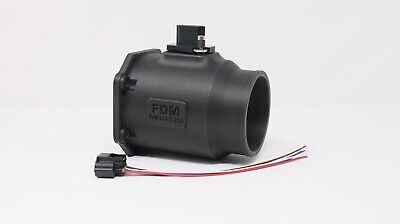

have a look a the R35 one as this can work very well with Nistune. Check with Edward Ralph for more information.

The apexi carn't do map + throttle based load mapping so you will still need a afm.but should allow you to use either z32 or r35 etc

z32 us the usual upgrade, but, now the R35 is becoming popular as it has higher resolution readings, better for your air intake.

The issue with the Chinese copies is the calibration is different to standard so at best would need to be mapped around and at worst will fail in a way that causes the engine to run lean or rich.
