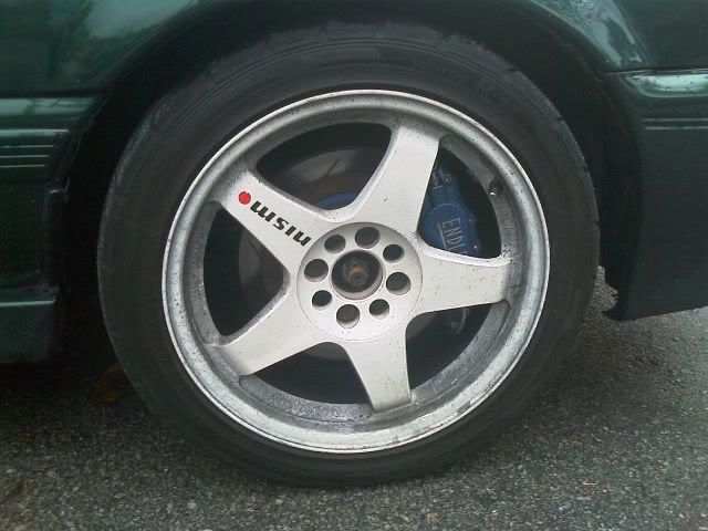

Recently i removed my Porsche Brake and Replace it with Endless 4 pot
This Endless Brake actually can clear 15" wheel
i am wondering which rim i should go with, 16" or go to 15"

I'f you are happy with the brake kit and your 15" wheels fit over them then I consider you lucky.
Keep the 15" and pop a set of R888's on.
cmng
Well , i comfirm that 15" will fit
emm i think i will get a Set of 15 and shot a R888 all round on it

The Endless 4 pot is From Evo3 .
and it just required minor mod to fit on Pulsar if you have been on the brake topic disccusion before
but instead of mod it .. i do a new bracket..
just slightly thinner compared the Original Bracket for Evo
dont have the pic on GTiR but on Sentra
