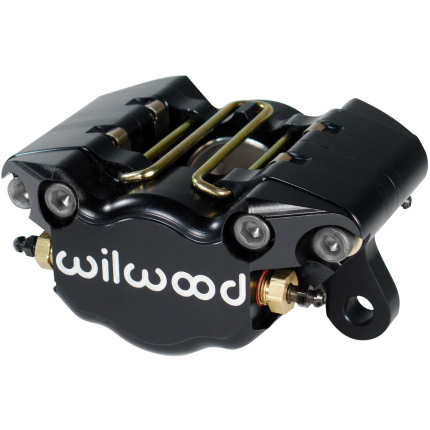

i know ap do a good rear calliper, similar too that willwood one, but there 1k, thats the whole kit though.
