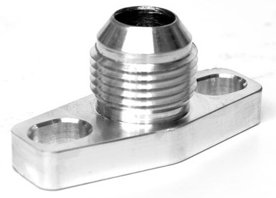

I bought an oil return flange that came with a 45% bend but it's too far away from the oil return on the sump to massage a pipe in between.
My idea was to weld/braze a -10 male fitting onto the standard oil return flange to make something that looked like this:
Then come off that with a 90 degree elbow with a short length of hose and then have a straight fitting on other the end to screw into an adaptor in the block. A bit like this:
So you'd end up with something that looked a bit like this (but with a much shorter bit of hose!) All depends on room though!
