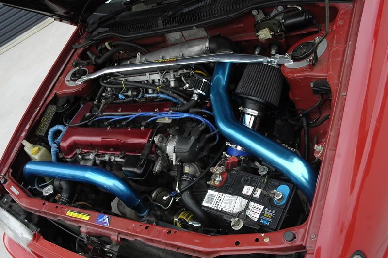

Hey guys,
When the car is cold the car is very lumpy. It idles when cold at 1500 or so and when hot drops down to 900-950.
When its hot it idles a bit better however it still seems to feel like a rotory.
Do R's run rich naturally because i have a fair bit of carbon on the back of the car and im just wondering if the car is running rich it will make the car run a bit rough?
Everything is basically stock on the car except for the front mount and the exhaust. Will these make the car run rich?
Ive had people say the stock FPR may be worn out and is not keeping rail pressure and causing the car to run rich also?
Any help would be appreciated.
Thanks

The PCV line should not go into the catch can;
As you can see the valve is beside the Oil filler cap, the other one it connects to is slightly under the green one with the yellow dot seen?
This pipe then runs into the TB's so having it connected to a catch can would allow it to leak vaccum and cause more problems :doh:
You can see in that one the catch can with the 2 blue silicone pipes and those are the only 2 that should be used! Only variation on this would be to install a filter on the pipe that runs from beside the coil down to the intake tube and block of the pipe or make a new one in Alloy or stainless.
Hope that helps :?
