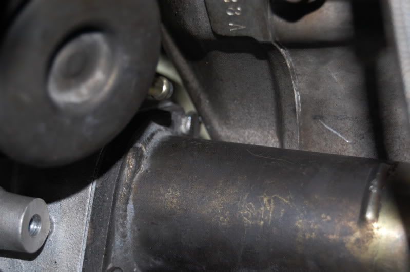

i'm currently installing a gt2871r on my gtir, what about the "bolt-on" i have a problem with the cold side outlet, it's hitting the tranny/engine casing. is that normal ?
ok searching older thread, i saw that using 2 gasket could help. i'll give it a try, as i need near nothing more to clear the engine. it's just that i don't want to put a stress on the t25 flange (4 bolts) when i'll torque the 8 manifold bolt/stud.

as said just get the grinder out and chop a bit away off the block, you wont cause any damage
