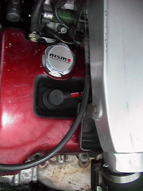

today i fitted all new ngk iridium plugs today,cleaned cap and arm which seemed ok and its started great got warm and reved fine,later on run it again went to use it and the miss reappeared
the thing we did notice was plug 1 nearest the drivers wing,the port where the lead goes was full of ice !!!! we had trouble getting this plug out too as the ice around it made it hard to get the socket on to it ,we eventually got ride of the ice changed the plug but the lead didnt want to go back on again and may be damaged
not sure yet
hopeing for some ideas please guys
