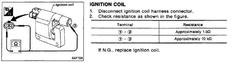

that'll be a check for tonight at work then I don't actually own my own multimeter. however after 5months of gtir ownership im thinking it may be a good investment along with a long list of other tools.
