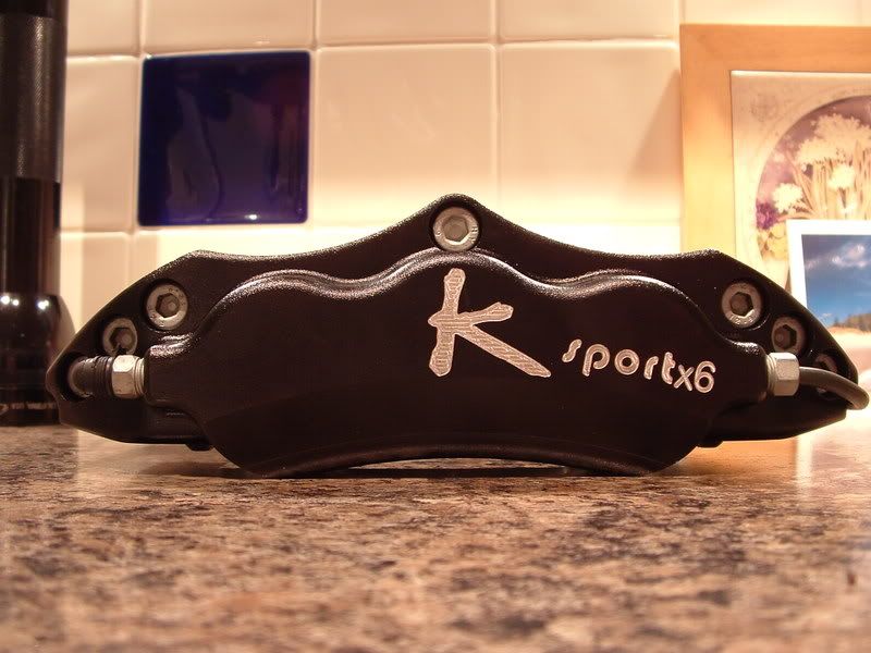

1st impressions.

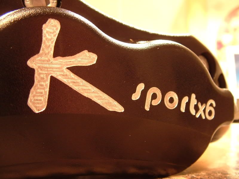

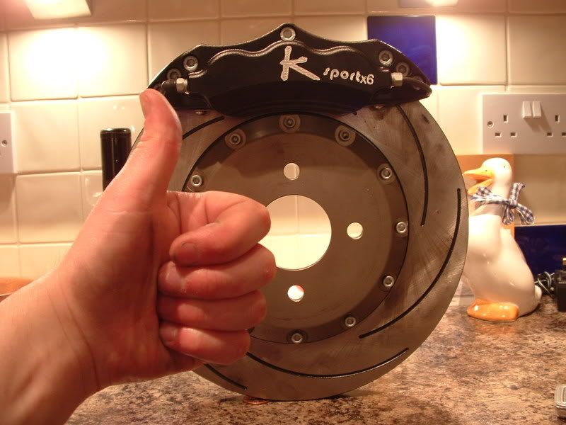

The kit seems to be well made, visually there are no marks or machining errors and all the parts, seals and bolts are in good nick.
Kev has sent the K-Sport “sport” brake pads with this kit but he stressed (for my safety :shock: ) that I should use DS2500 pads due to my track usage and heavy braking, so even though I was keen to see the limitations of the “sport” pads I’ve taken his advice and gone with the 2500’s.

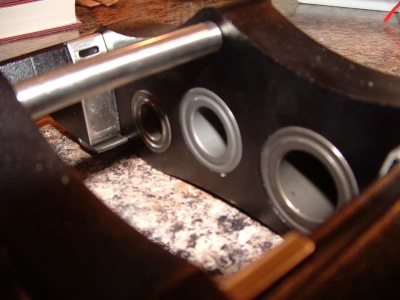

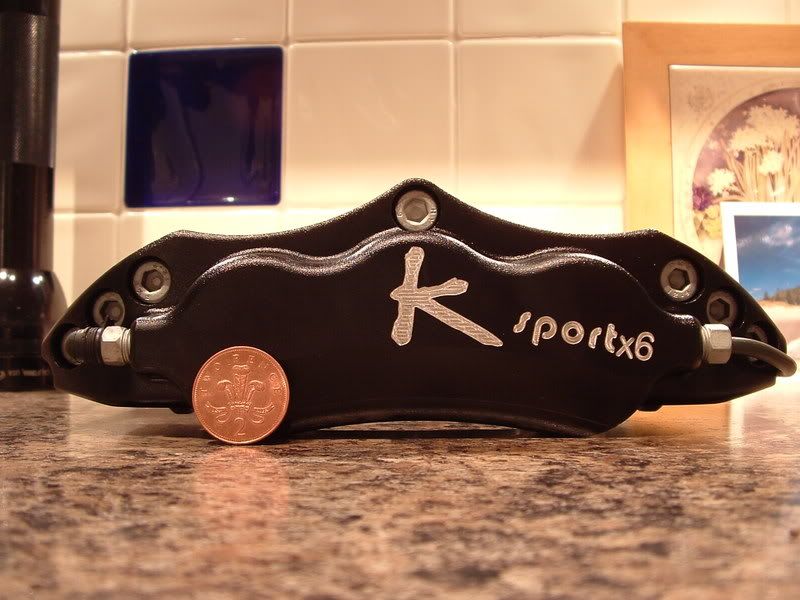

I was surprised to feel how light the calliper actually is compared to the Wilwoods, though the K-Sport is bigger its feels lighter that my Wilwood calliper! It’s also in a glorious black finish and tbh I’m glad they turned up like that as they subtly sit behind my wheels without saying “raagghh look at me”

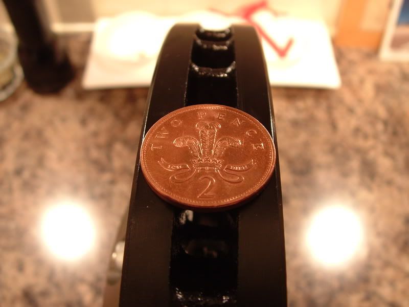

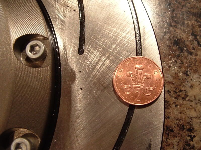

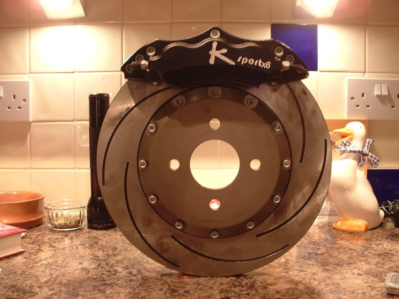

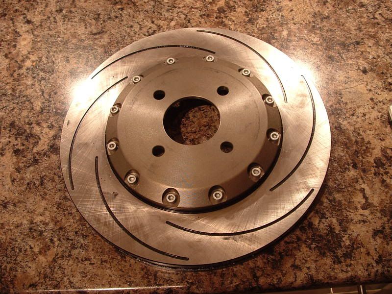

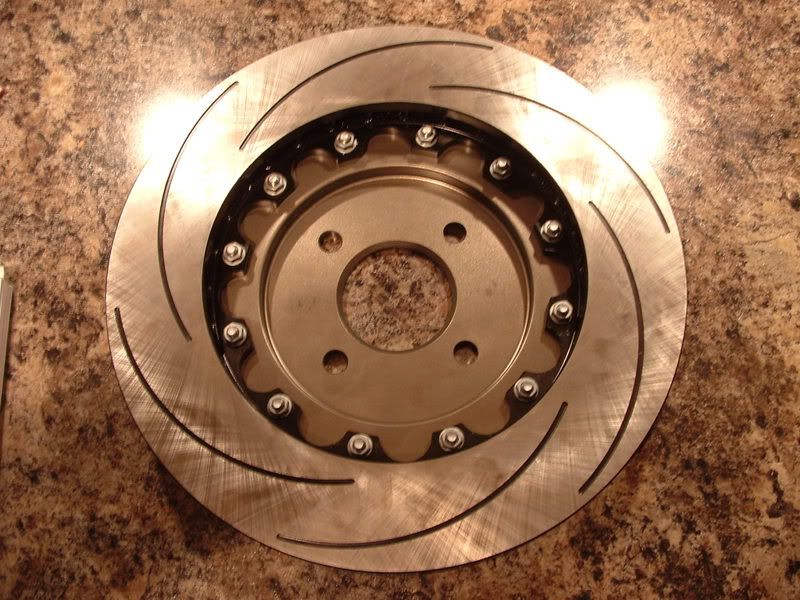

The discs even thought they are only 304mm they look massive when you take them out of the box and again feel lighter than I imagined. They are also thicker (28mm) than the 24mm discs I use now.
Everything is well boxed up and all bolts and nuts are bagged as any brake kit should and the instructions are also included.
So far everything seems in good order and no major problems!

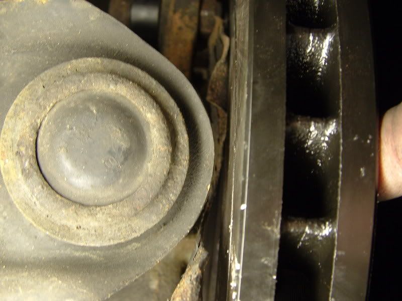

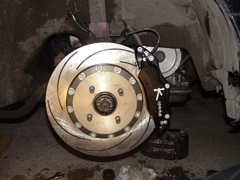

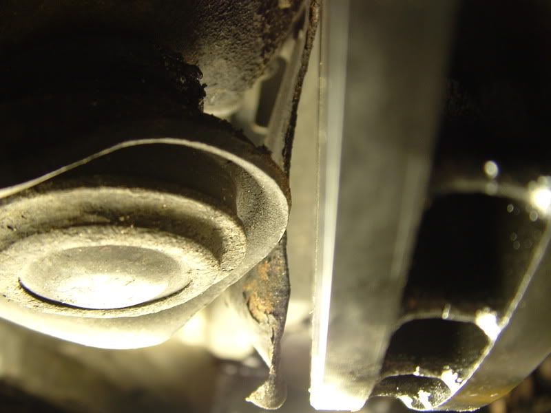

Now I only did a quick test tonight to see if the kit fitted and what the clearances were.

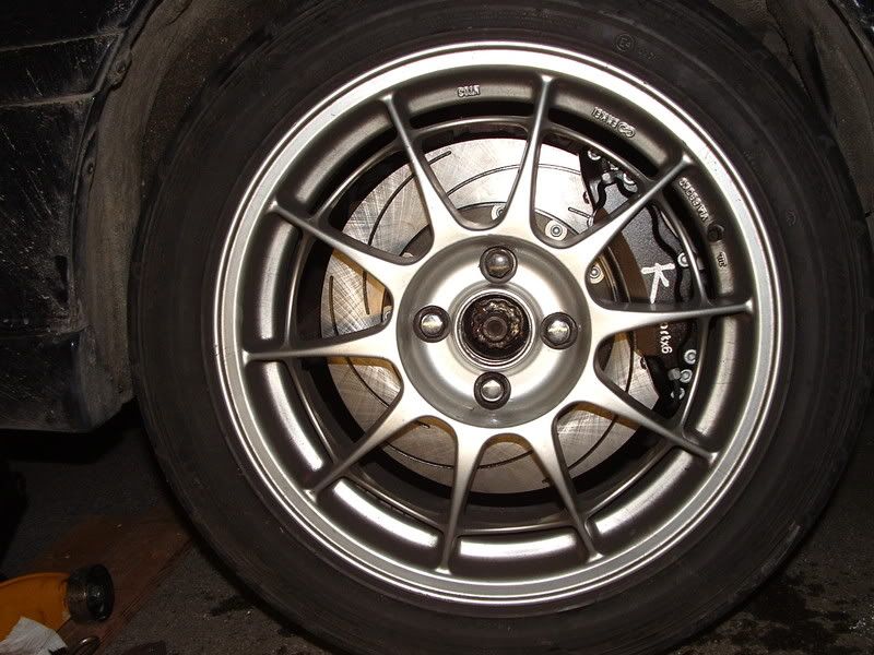

I’m very happy to announce that they fit with space between my calliper and alloy spokes (3-5mm) as does the disc to the ball joint which has good space between them both too (3-5mm). At this point it is only visual and I will measure these gaps tomorrow when I have more time (no wheel were spacers required).

Now at this point I was taking pictures like a paparazzi at a glance of seeing Brittney’s rear arsé cheeks, but due to the retardness of my camera, its had a hissy fit so you’ll have to wait till tomorrow to see the finished products (yes I am a tease ;-)) but I can say they look well under my 16” Enkei wheels and with them finished in back, give that feel of: “yes I’ve got 6POTs but I’m not showing off to everyone, yet there on for a purpose” 8)
