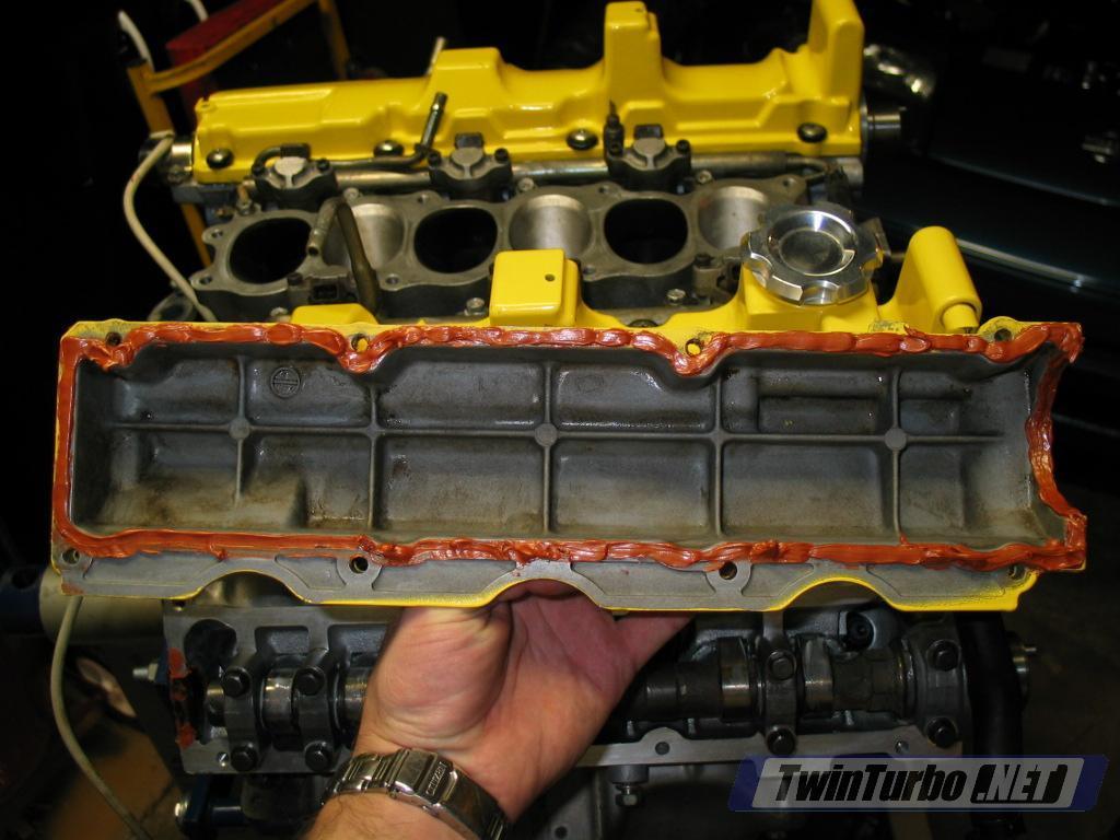

I applied mine to the pan. I laid a 4-5 mm bead in the groove and then on the inside of the pan around the bolt holes. I did not go around both sides of the holes, just the "inside" side.
This picture is not mine, I used the blue permatex stuff.
My bead was about half as wide as that one too. Notice in particular how the liquid gasket is applied on the oil side of the bolt holes, not the outside.
