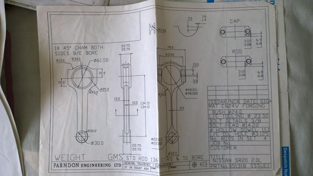

Educate my uneducated mind please haha,, are those rods shorter than stock even though it says 90mm and with that spec sheet? Am i wrong/stupid in thinking the standard rods are 87mm?
Are you getting the stroke and rod length mixed up? Standard stroke is 86mm, strokers go 90-92mm. Rod length between centres on your diagram is 134.5
ckd281081
yeah i probably am mate, hence why i started this post, to educate myself ;)
So going by the spec sheet for the rods, are those rods shorter? But yeah the strokes 90mm as per the receipt
To gain a longer stroke the crank has to move the piston up and down further in the bore, farndon kits use stock dimension piston ( gudgeon pin to crown height) which means the conrod will need to be shorter to stop the piston from protruding from the block surface by 2mm, this means the rod is 2mm shorter than stock. We can then go into the increased rod angle at 90degree to the deck surface, extra friction from the rod angle on thrust load (piston rising and falling in the bore) and the decreased dwell and burn time at high rpm because the piston stays at top dead centre for less time every revolution, then at high rpm the piston is exceeding 25m/s which is not good for piston life.....as said its horses for courses...standard sr20 stroke is 86mm , with a stroker I think what you will gain from one area you will loose on another, I also personally prefer a bore of 86.5mm with a 87mm head gasket for a compromise of liner strength and deck surface coverage from the head gasket and use cosworth headgaskets, arp head studs are inconsistent in use and torquing down due to design so use standard ones as they are strong enough to go north of 600hp, the next question is who built the zero mile engine? Because what I know about some of the Mahle pistons in sr20 engines it may not suit your needs.

Looking at at the spec sheet I have for the rods, have they definitely been machines -2mm?
