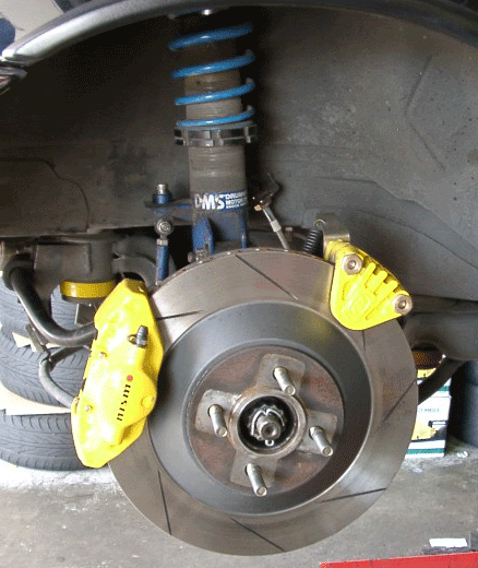

Well you seem set on it, but maybe just try upgrading the fronts 1st and see how you feel, unless you have an unlimited pot of money and time then do the lot
The front discs won't fit over the hub flange on the rear without some machining. You'll either need to take some material out of the inside of the disc or off the outside diameter of the hub flange ;-)Havnt had a close look yet bt the front and rear standard discs look like a similar offset which would make moving the front to the rear alot easier
If that's the case, no wonder you've got brake fade its the fronts that are overheating as they are pathetically too small for the car itself. :roll:Stock for the meantime Andy.
That above pretty much sums it up...skiddusmarkus said:If you really want to do it, its your choice but unless its a dedicated track/race car that has problems with the rears overheating, what's the point?I usually like to plan ahead and have overkill on things which in this instance would be to fit rear vented "just in case" but then I also do research first and I don't think I have ever come across anyone complaining of rear brake overheating problems/wear.You just have to look at the specs of peoples cars and vented rears just don't come into it.
skiddusmarkus said:Now, do you really think that 99 percent of R's out there need vented rear discs, or do you just want them because they look/sound cooler?
Funny why they're listed as an ap caliper when that's the brembo handbrake caliper that comes on ferrari's and aston's. 99% sure it is anyway.
