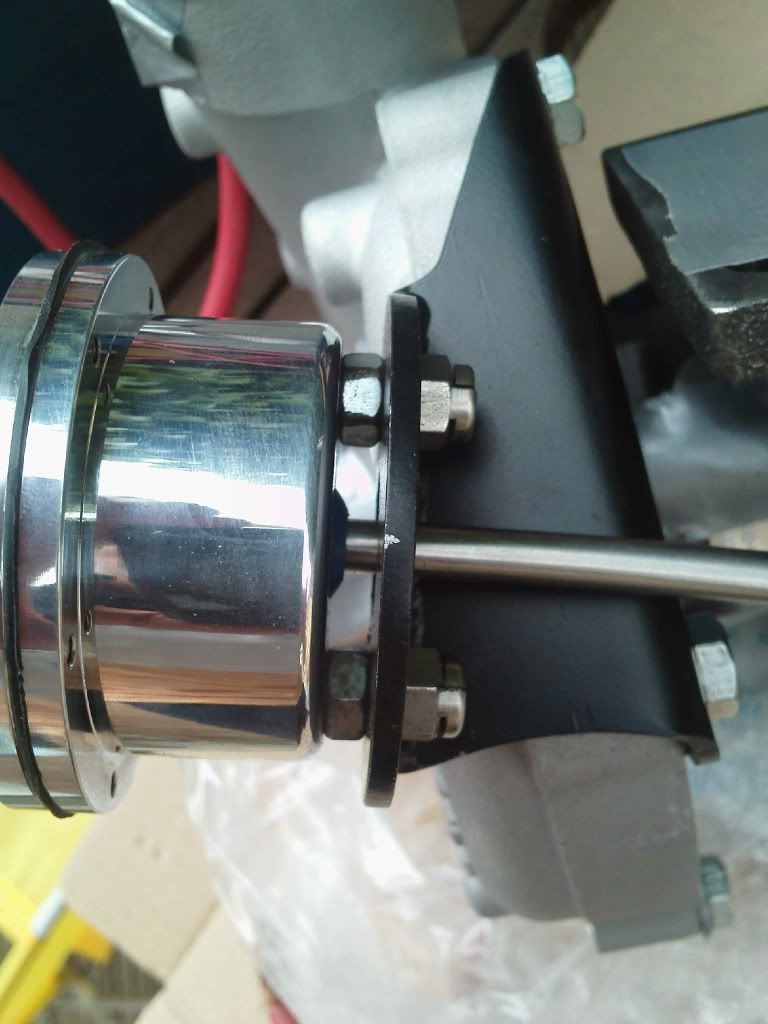

When I set the forge actuator I just adjusted it until it was nice and tight at rest with no rattles on the penny.I might have maybe been able to get another half turn on the rod thread but it seemed a good seal to me already and I didn't want to be pushing the rod back into the actuator if you know what I mean.
you need some tension on the arm/actuator, they are usually adjusted so that the hole is halfway past the post on the arm.
If there isn't enough tension the boost won't be controlled enough as there isn't enough spring pressure.
That sounds like it's your problem and it's been made worse by the 3inch zorst allowing the turbo to spool up a lot quicker too.
I would still pipe up the actuator (after adjusting the rod) bypassing the boost controller and see what happens.

I think you are right, was just hoping it wasn't going to be this.Is it possible to adjust the actuator rod in situ or has the turbo got to come off again?Does the rod travel inside the actuator as it opens the wastegate as if it does then it might be possible to undo the 2 nuts that hold it onto the bracket and then pull it out enough to unscrew it-I guess then the problem is if you tighten it up even more then it will be too hard to get back onto the bracket, unless maybe the bracket could have 2 slits cut in it that meets the holes to allow the actuator to slide into the bracket then be secured with the nuts.

If you have the hole 1/2 way over the stud you will have to pull the rod out of the actuator to put it on the wastegate stud.
on the end of the rod that comes out the actuator, there should be adjustment (undo the nut and the end should turn on the thread)

as you can see, there's adjustment on the end of the rod.
From what you've said you will need to "shorten" the rod so you have more tension on the spring.
Yeah I already chopped half and inch or so off the end of the rod as it was too long.It was probably a 1/4 of the hole on the end of the rod too short so the wastegate flapper arm was tight when I put the end of the rod over it.

The boost is controlled by the spring.
the boost pressure presses on the diaphragm, when the pressure against the diaphragm is greater than the spring pressure (that's on the other side of the diaphragm) the actuator rod gets pushed out and opens the wastegate. The opening wastegate lowers the pressure inside the turbine housing and the turbo slows down, that causes the boost to drop.
If the boost pressure drops too much then the spring overcomes the boost and the wastegate will close, allowing the turbo to spin faster as the exhaust gasses aren't bypassing the turbine .
in effect it has nothing to do with the wastegate (it does but not at this simplistic level)
Ok, I think I understand now.So it probably needs another turn or 2 on the thread to get some more tension on the spring to make it work properly then.Ah well, off comes the turbo again I guess.
