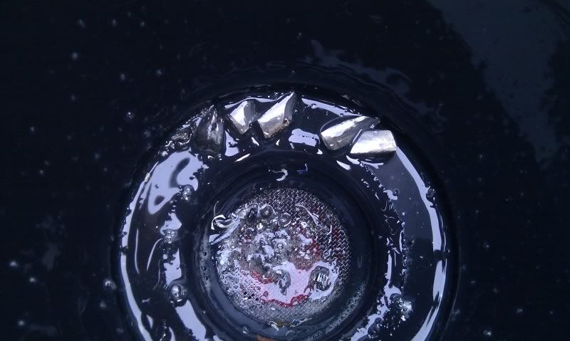

I destroyed 3rd gear in practice this morning, pretty sure theres no teeth left on it :doh: The annoying thing was i managed to do well over half a lap with no 3rd and end up only 5 secs behind the quickest car in the class, i wasn't last either :lol:

torque is the killer of these boxes, 3rd and 5th are the two weakest gears (from the tooth pitch and size) . having built more boxes than most have had hot diners i can tell you that you are on borrowed time, age definatley and abuse does have an effect of course but that does not defeat that the gear is simlpy weak machined cast shit to start with, for most people you could get away with putting aftermarket 3rd,4th,5th in the gearbox. having also built a box with new gears i can also say it lasted about 2 mins with 420lbft torque and gave up and striped 3rd.
You can actually see on the gears from high powered cars gearboxes the pressure causes the tooth to compress and push out on the sides too...........not good.

I drained the oil earlier and as expected found this, I expect the rest of them are stuck to the magnet in the bottom of the box.
