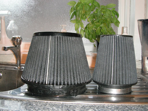

Me and my dad cobbled this one together about 10 years ago.The filter is huge, not seen anothyer as big as this width wise.Am thinking of having a new flange cut now to fit onto my Z32 as the one I have on is half the size.
I made a template out of a cornflakes box to get the shape I needed to cut the steel then rolled it, I can't weld so my dad tacked it up then welded on a 1" strip to form the lip the filter goes onto.Then just cut a flange to fit the MAF and welded that on too, using a cork place mat as a gasket.
Oooh that looks good! Any suggestions on who to ask, or anyone who's got access to a lathe and some spare time?
