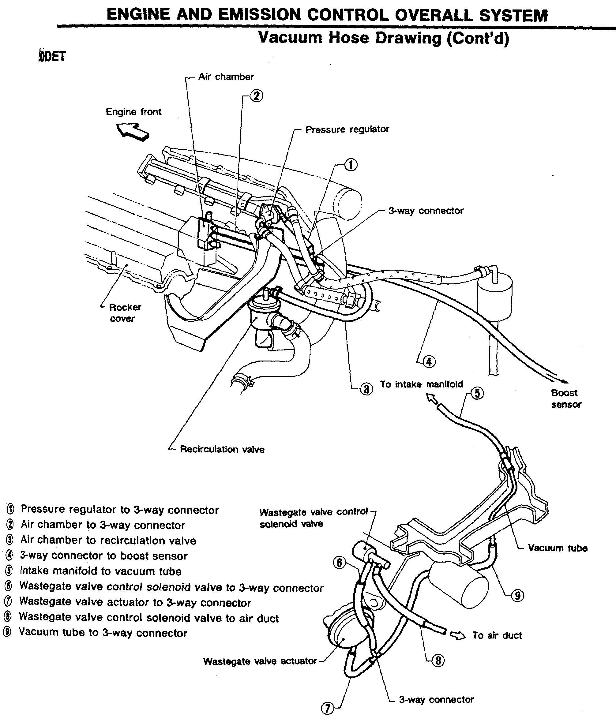

Hi, for some reason yeserday my R just started to miss when i put my foot right down on boost only, it doesn't miss when idling or normal running, only on full boost. I don'e know if this is relevant as well but after it messing around i notice that the boost gauge doesn't fall right back to -7 on idle and i thought it used to.
It has had new leads, plugs and it hasn't rained for a while.
The only time it has done anything similar is when the bleed valve was out too far, but doing it up again solved it but now it's doing it again so i've had to do it right up, STD Boost
