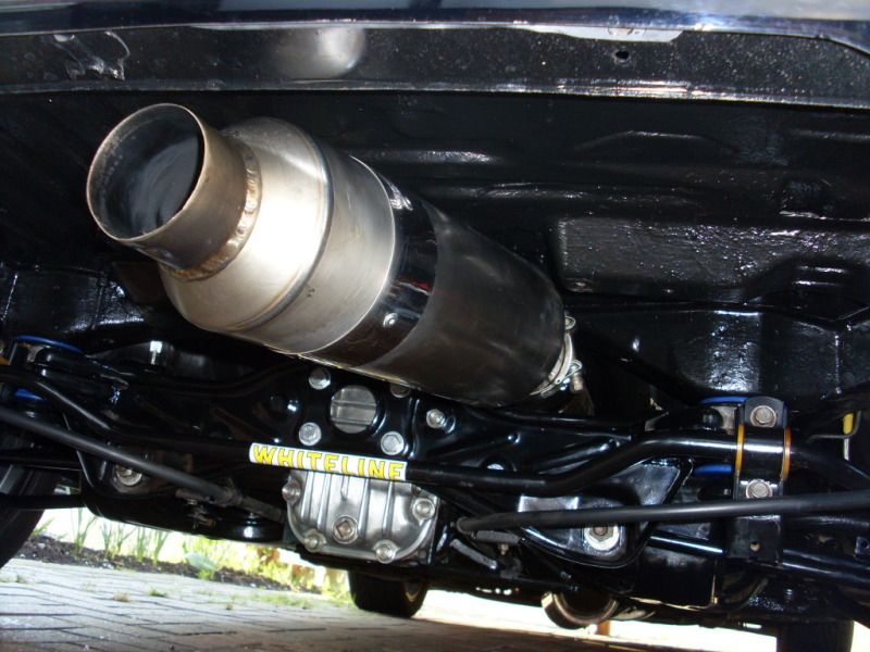

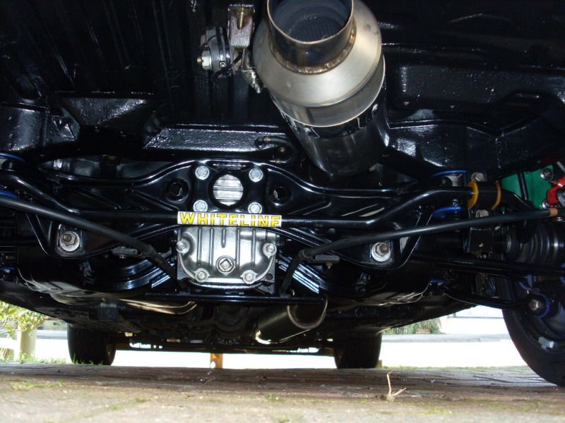

That's my old car that was custom made at AAS in Newcastle and was very quiet when poodling along and very track friendly.
vpulsar
How many silencers were in that system Rob?
Two mate you can see them both in that picture, The front one was long thin and then the big back one that is a bit like the standard pulsar exhaust but doesn't cross back on its self hence why it exits the wrong side of the car.
I'm pretty sure that's how Jim (and possibly Geoff) have theirs too; one of the "hot dog" style silencers in the pipework, then a large back box on the other side so that the pipework doesn't need to be bent back on its self. - I'm sure Geoff will correct me if I've got that wrong.
Looks pretty similar to the above.
I think there are also a couple of people who just have the largest "linear" boxes they can fit at each point between the front pipe and the exit; that seems to work quite well too.

The good thing about mine and Jim's design of system is that its not only quiet it also flows very well indeed, My car dyno'd 519 bhp at 1.9 bar so you don't necessary need to be loud to get good results, Plus being a tad quieter means the plod doesn't bother you so much, In Fact in the ten years I owned my Pulsar I never got stopped once mind you they wiggled they finger at me a few times when I had the goose fitted lol.

Mine has a janspeed decat muffler and a rear box 47cm long x23 cm wide which exits on the passenger side if it was any larger you would not be able to use the existing hanger points . It is probably the same size as Jim,s in the photo
That "middle box" is much smaller than what I have. Mine is at least twice as wide as yours.
Granted I had to removed my CAT shield to get that silencer in, but it made a big difference. I'd look at having that middle box replaced or the rear silencer (pictured) should be replaced with a larger box.
