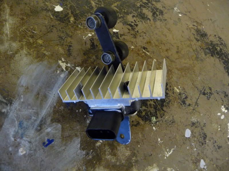

Probably not the coil. It's probably the transistor (or whatever it is) that's attached to it. - There's a mod the Australians run to heat-sink it and stop it over-heating. Maybe that's what you need in Malta too?

Ok great. So it is in fact overheating and not just a coincidence. I am running a TMIC wich will not help it either. The heat here is another big factor to consider too.
It's not usually a problem in the UK - I'm still trying to find a link or a picture of it.
Might be a complete red herring, but it sounds like it might be your problem.
Try this thread.

Would be a good thing to put some plastic washers between the block and bracket to reduce heat transfer too.

Heres what i have done with mine...
Heat sink stolen from a playstation 2 and the rubber spaces removed from an old tailgate.
