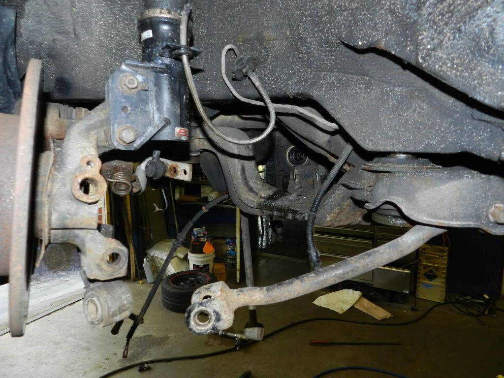

First thing is to get the car up.
Take off the rear wheels
Remove 32mm axle nut

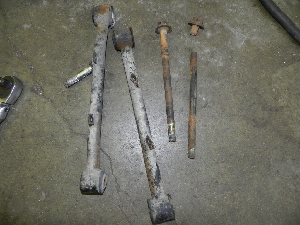

Remove 24mm long Parallel link bolt (good luck)
If you break one and can't find a replacement you can use an STI bolt. They are slightly longer but just use some washers and they fit perfectly.
Remove the 24mm Trailing arm bolts

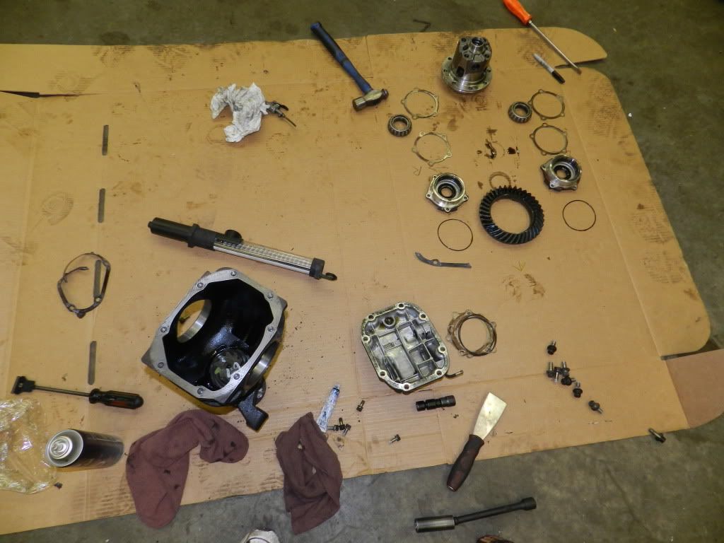

Clear a work station
Remove 8 14mm bolts from end of diff and remove end casing
At this point it is a good idea to check the ring gear tooth contact with prussian blue or ferric oxide
Remove 10 12mm bolts from the side caps
Keep the Left and right parts separate and marked the shims should stay with the same side
Diff should be free now inside the case
Remove diff from case, this part is tricky, when you get it it will just slide right out. You want to stand the diff on end with the flange down. Then rotate the diff so that the ring gear is facing up and at the same time pull the diff out of the casing. If you get it right it will be easy. Don't force it. If it's not working, take it slow and think about it.

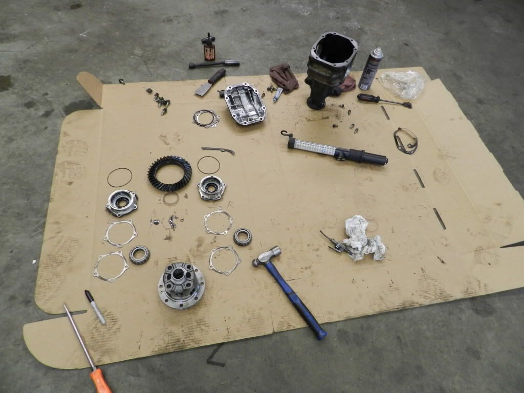

Now that the diff is out you have to swap over to the nismo diff. I had all new bearings waiting just in case, but I decided to re use the old bearings as they were in great shape and already worn in with this case.
With a bearing puller, yank the bearings off both sides of the factory diff
With a press, you guessed it, press both bearings on the Nismo diff, taking care to not mix up the left and right sides
At this point I would remove the C clips that are inside the Nismo diff. They caused problems later as they are so new and stiff, and also too thick for the passenger side shaft c clip groove I have a feeling that the ideal solution is to find nismo side shafts(good luck), but rest assured that I installed two Passenger side shafts with no problems.
After putting the diff back into the case and bolting up the side flanges, check the tooth contact again. If it is not centered I would just go to a diff shop and seek assistance, as adjusting everything is so damn complicated without the proper tools. A good nissan mechanic from the olden days would be a god send as there exists very specific tools solely for this diff, and if someone knows how to use them that would be heaven.
As luck would have it my tooth contact was beautiful. Then check the total preload. You will need a torque wrench that reads inch lbs or equivalent. Turn the pinion flange several times to make sure everything is seater properly. and put a socket on the nut inside the flange. Turn the flange with the torque wrench and watch the needle indicator to see how much force it takes to turn the pinion. Proper range is 8.7 - 13.9 inch lb. If it is too high add same shims to both sides of the case. If too small, yup, remove same size shims from both sides.
