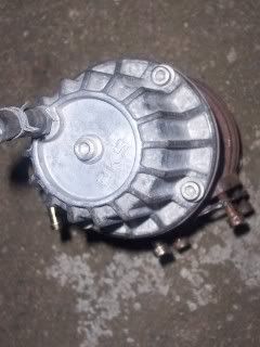

I have a hks s/s racing wastegate, there are 2 nipples on them one on top the other on the side, were do these to vacum pipes goto.
R-Type
The top nipple should go to your boost controller solonoid & the lower nipple to a boost pressure source.
1&onlygti-r
ie the boost pressure source (any vacume pipe is that correct)
