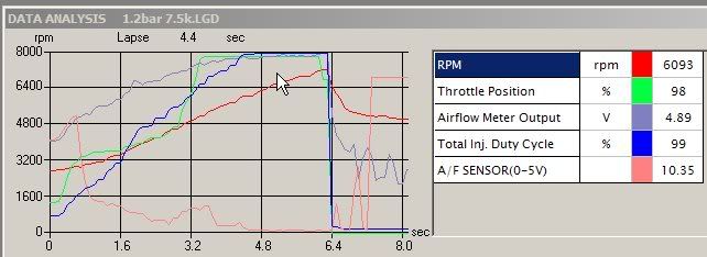

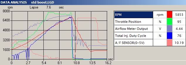

here are some graphs from my emanage
AEM air fuel connected, scale is 10-20 air fuel ratio
injectors scale 0-100%
airflow meter scale 0-5V
throttle scale 0-100%
std boost
and at 1.2bar with std injectors and std airflow meter
as you can see it runs really rich at std boost, an at 1.2bar airflow meter maxed out and injectors are at 100%:shock:
what you guys recon?
