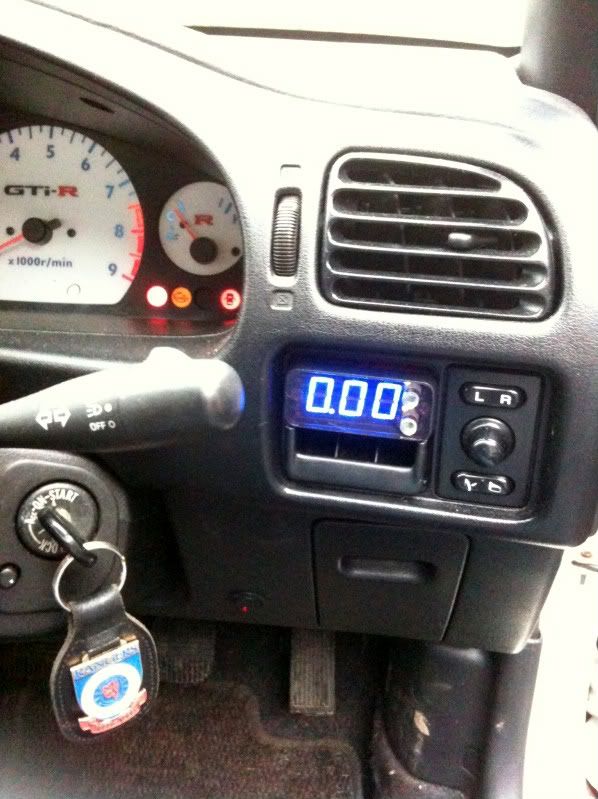

Ok so I got the unit and fitted it, its really small so easy to tuck in anywhere. I just cut the coin holder in two and slotted it in there, fitted like a glove.
Screen is a tad bright, prob too bright for night driving, but nothing a tiny bit of window tint wont cure.
The only thing about it which im not sure if its normal, is that you need to run a hose to the unit itself for it to measure boost.
Having never fitted an ebc before I just assumed it would have an external sensor, what way do most boost controllers work???
Seems simple enough to set-up, there are settings for Duty cycle and Gain, and there are four switchable memorys.
Havent had time to set it up thoroughly, but seems to do the job ok. Seems to spike a bit just like the bleed valve I had previously but hopefully messing about with the gain will sort that.

That looks quality mate nice one,my manual one spikes a little but I don't think it's anything to worry about,I just keep an eye on the boost gauge!

Had another fiddle with it tonight. Turning up the gain really affects it. I put it on its lowest boost setting and turned the gain up and it was like lifting my foot on and off the throttle. The boost went up and down repeatedly.
Turned the gain down and got it set up so that it spikes to 1.1 and holds at a bar.

No its no problem running the pipe, but just thinking it may affect the reaction time, because thats a length of pipe running the whole way from the FPR to the steering column area. Will do for mean time anyway.
