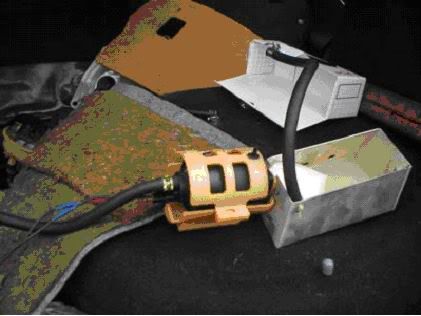

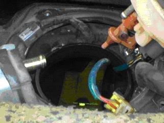

Sorry for late reply..... been busy... :doh:
Sounds like u are making headway..... here's a couple of pics all the same!
