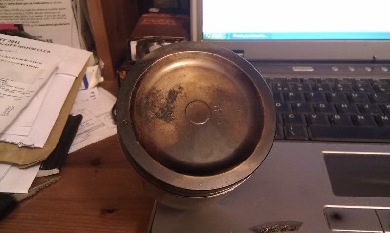

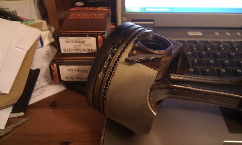

Its a shame my engine suffered a broken ringland on No1 as i wanted to push the standard pistons a bit more really :sad: But thats the risk you take, they could last a week or years!
For an engine that has done 135,000 miles and was running a fair bit of power all the pistons were in very good condition really.........apart from the bit that fell out :lol:

Looks like CP's it is then. Danny if you remember i mentioned i was worried about a small amount of oil in No4 cylinder when we were at Dens a couple months ago, that turned out to be one of the valve stem oil seals but it was lucky i decided to strip the engine down anyway as there were no clues whatsoever that this ringland on No1 had broken.
Were you running 1.7 bar on the standard internals ? Gt3071r?
Yes, it lasted just over a year after bolting on the 3071.
