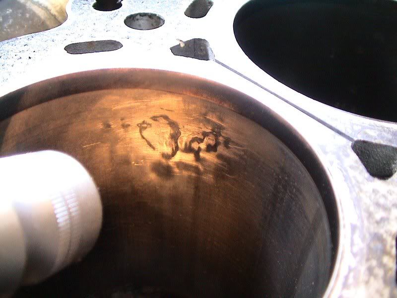

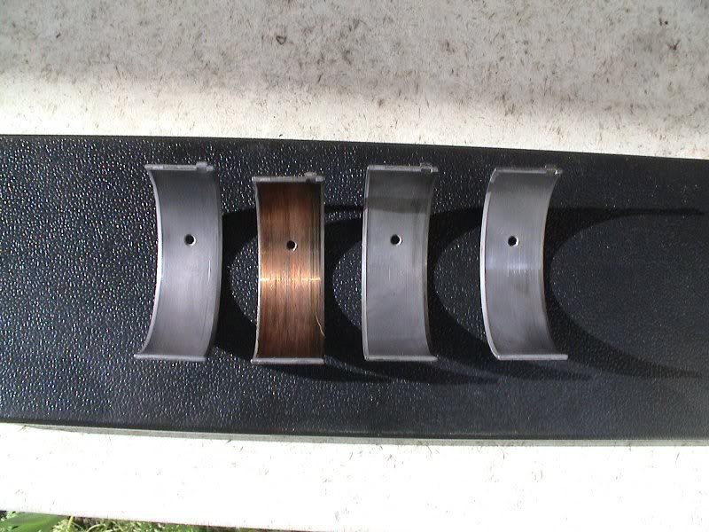

Hey bud, just thought you might be interested to know, I finally got round to stripping that engine I got from you and found out what was wrong with it.
Looks like you spun a bearing
  Also, luckily you stopped using it when you did because you were about to blow a hole through a liner
  Glad you didn't because it means I can fit new liners and she's a good un ( and a new crank as well ). Here's a couple of pics -
Spot the odd one out ? ( it even went a nice shade of ginga, like your hair
