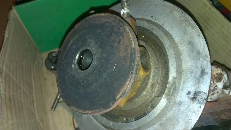

This is the heat shield Danny is talking about, the bearing that collapsed sits about 10mm behind this.

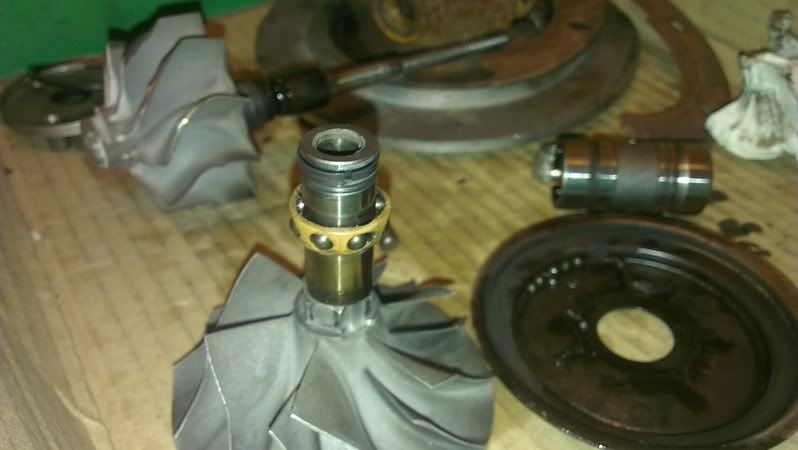

This is the bearing from the compressor end of the turbo with the bearing cage still intact.

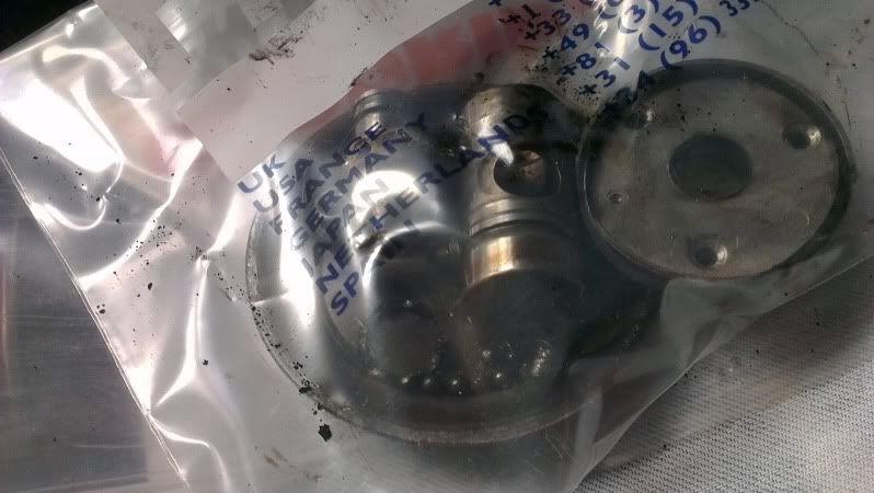

This is the bearing that collapsed, the plastic cage had gone rock hard from the heat.
