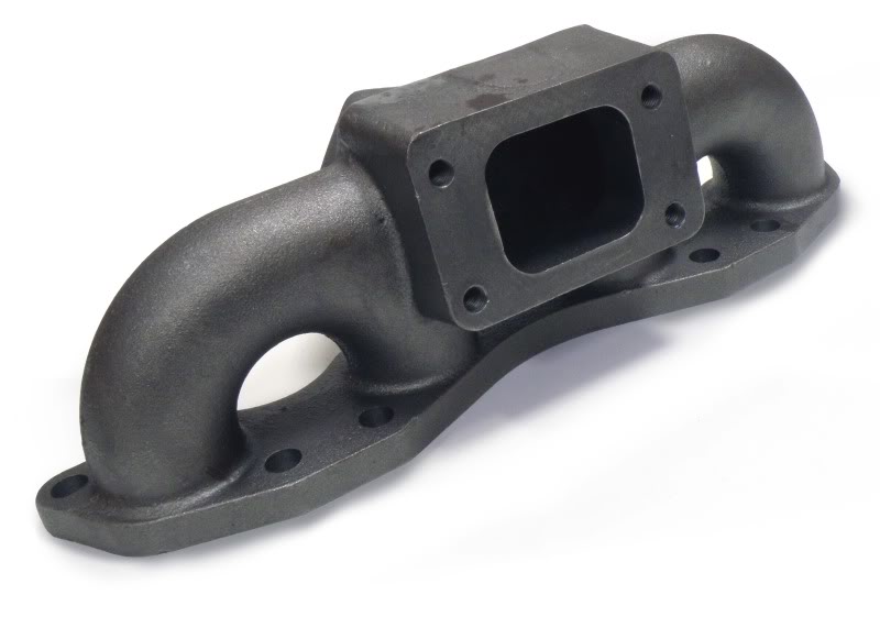

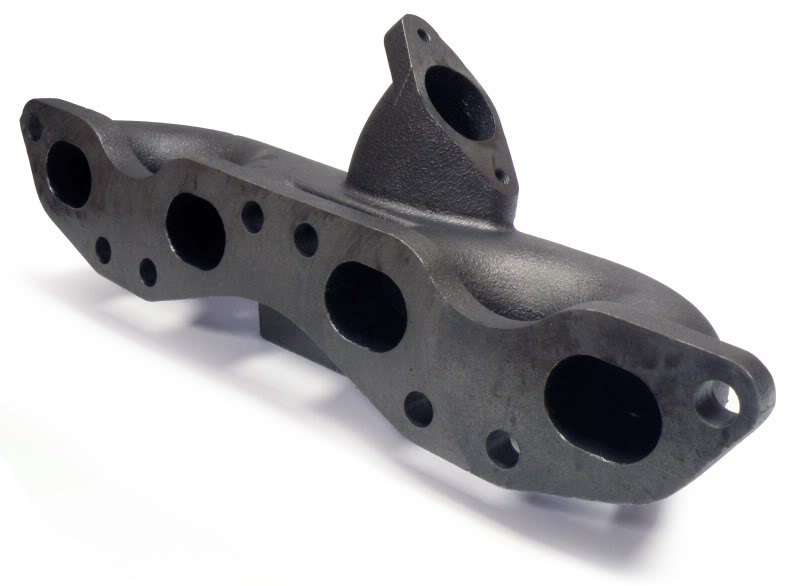

So these items would allow me to avoid purchasing a new turbo costing several hundreds of GBP, but leaves the problem of finding a suitable manifold. However, searching Ebay allowed me to locate a cast GTiR specific manifold with both T3 and 38mm wastegate flanges. Here are some pics of the item:
So, while this manifold may seem suited for the job, am I missing something obvious? Could a turbo be fitted to this and still clear the block? Or would I typically need all sorts of spacers and angle adaptors? Would I be better scrapping this idea and just saving for a GT3071RWG? I know a custom downpipe would have to be made up in addition to elongated water and oil lines, but I would imagine this is quite an easy job compared to everything else?

Look on the USA forums about this manifold, they use a lot the GTIR manifold to suit their sentra's so somewhere there you will find info about this, for sure.
Smo
This manifold is a poor design - try to picture the gas flow from cylinder 1 and cylinder 4. They head straight at each other and will create turbulence, it's not terribly free-flowing.

It's top mount. :)
Ahhhh, thanks! I suppose top-mounting doesn't really leave much room underneath the bonnet! Has anyone top-mounted a turbo on their GTiR before? I think I recall someone trying it in the past................

Dobby on here as a top mount to name a few, its not realy that difficult you would just have to re make a elbow to meet the downpipe or have a side exit, new oil return and things made up like that, does look quiet nice having the turbo up in view but is it realy worth the hasstle if your stock job can do just the same performance wise lol

I have the protech version of this and the bonnet closed fine with a gt3582 on it, it also had a 8mm spacer between the turbo and manifold so the turbo would clear the rocker cover. Hope that helps mate.

see if you can get it not top mount, give them an email may have the stock possition you never know ;)
