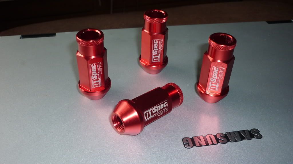

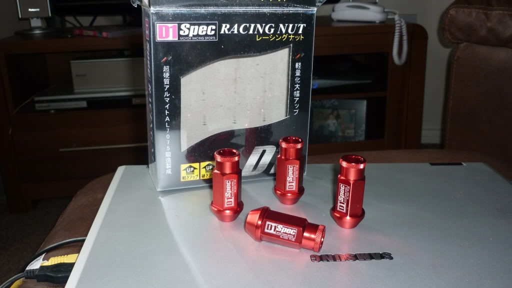

Iv come across mixed reviews on alloy wheel nut, so i thought id take a punt on these and monitur how they do over the next 12 month.
I choose them simply because i thought they look good they certainly are more pleasing on the eye than steel ones that were
They were 38.50gbp delivered from a vender on ebay,
spec.
Material:- AL-7075
Pitch:- 1.25
length:-50mm

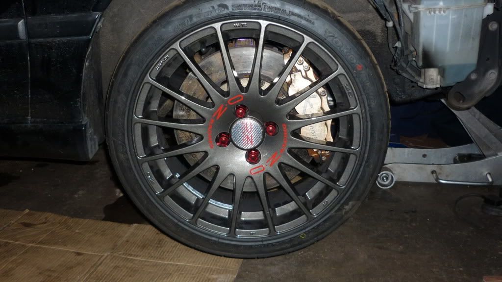

Fitted by hand and then torque'd to 80lbft as recommend, not a windy gun in sight.
There very lite which i guess could be one of the reason why people don't trust them,Ill certainly found out how they cope under hard cornering at my next trackday which is schedule'd for the 20th november @ cadwell park.
results to follow.................

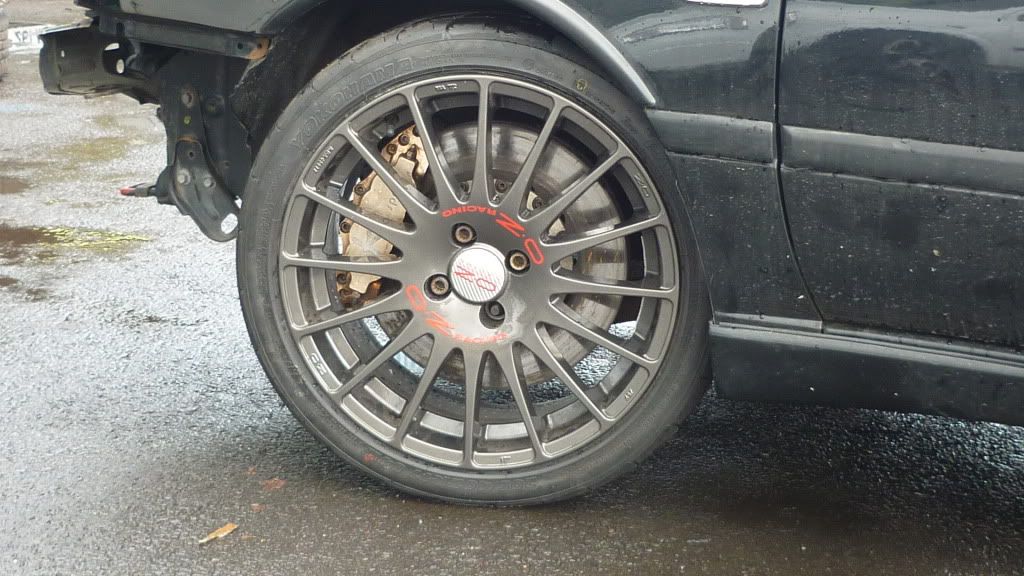

I've had the same lightweight nuts on my pulsar for years, not sure what brand though - they were on when I bought the car.
They can bend/strip if you use a gun to put them on/take them off - but beyond that they've been fine. To be a little more cautious I put some new locking nuts on the other day, but I just keep an eye on them.
