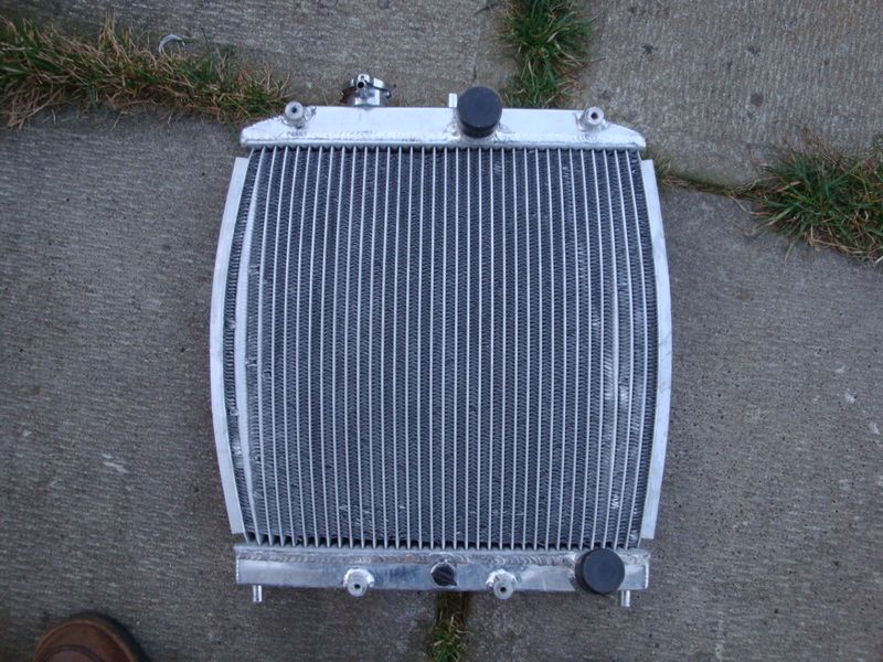

ive just got a koyo rad come in on car ive bought which I maybe selling soon
the ebay rads are ok but they do tend to deform over a period of time
had mine for 18 months and the end tanks have deformed outwards but still does its job with no leaks, so not bad for the oney I guess

iv tryed a couple of alloy radiators one was a pro alloy and after time i kept having to top the coolent tank up im now using a uk sunny rad that i paid £30 for and its been great

The way he core is made up is different from what you would get in a automotive rad. The water ways are ment to be thiner so it slows the water down and heats it up not cooling as well.
think you mean so it slows it down long enough for fans to cool the water rather than it rushing through!
which could be the reason they mis-shape easily as the thermostat is designed to do the same job (in holding coolant up long enough to cool) so by having bigger coolant bars the pressure in rad would be a lot greater than one with smaller waterways
mines nowhere near as bad as that but yes same kind of thing
which proves the above really
